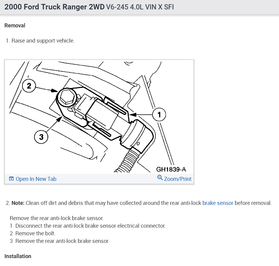

Where is the rear wheel speed sensor on a ford ranger 2000?

The rear wheel speed sensor is at the top of rear differential. Here is a diagram below to show you. Check out the diagrams (Below). Please let us know if you need anything else to get the problem fixed.
