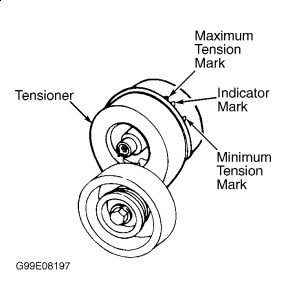

2000 Ford Ranger 2.5 auto. Hard to steer when i slow down to turn . doesnt happen all the time only every now and then. Full of power steering fluid, belt tight. Only have 55,000 on the truck. Should i change the power steering pump?

Hello - I would first check my belt. Do you have a serpentine belt??? I show you do. From what the manual says your belt tensioner has a wear indicator on it..........I have a pic of all the other engines other than the 2.5. I have attached them to maybe give you an idea of what to look for.
https://images.2carpros.com/forum/automotive_pictures/248015_5_38.jpg
https://images.2carpros.com/forum/automotive_pictures/248015_7_21.jpg
But I would first check that. It is possible that under load the belt is being stretched and stays tight. But when you let off the gas it is loose and the tensioner isn't putting enough pressure on it to provide you with power steering. Also look at all your pulley wheels and make sure they are okay and working freely. How does the belt look and have you ever changed it? BELT TENSION On vehicles with serpentine belts, belt tension is adjusted automatically. Some automatic belt tensioners have belt wear indicator marks located on top of tensioner housing. If tension indicator mark is not between wear indicator marks, belt is worn or incorrect belt is installed. Replace belt, if necessary

The wear indicator mark on the tension pulley was right in the middle. I did put on a new goodyear gator belt . Hopefully that will cure the intermittent problem i had.

You still might consider changing the tension pulley. Only because if it was in the middle with a older weaker belt……a newer stronger belt may pull it to the bad and be too much strength on the spring in the pulley. Just a thought.
I would call it more…..preventative maintenance….
