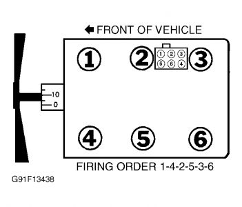

how do the plug wires wire up on a 2000 ford ranger with a 3.0 motor
Sep 17, 2008 at 9:35 AM
2CARPRO JACK
Experienced Mechanic
11,533 POSTS
Check the vin# 8th digit "U" or "V" then here it is, otherwise get back to me with the correct engine
