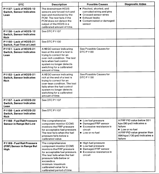

HANKHAWKINS13
what are the code p1151 and how can i fix it!
Mar 5, 2019 at 9:05 AM (Merged)
This code is because the engine is misfiring causing exhaust to go lean here is a guide to help fix the problem with a chart below.
Check out the diagrams (Below). Please run this test and get back to us.
Cheers
