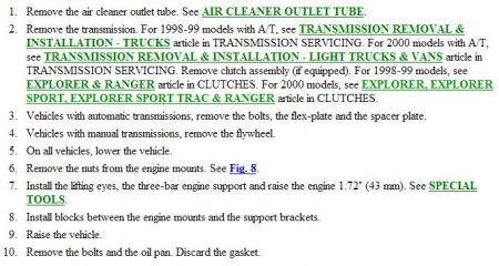

how do you drop the oil pan once all the bolts and starter are loose

Hi there, removal of engine sump as per text,
Mark (mhpautos)
Note the gasket may be chemically sealed and could require some effort to remove.
