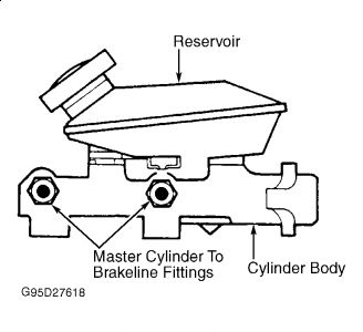

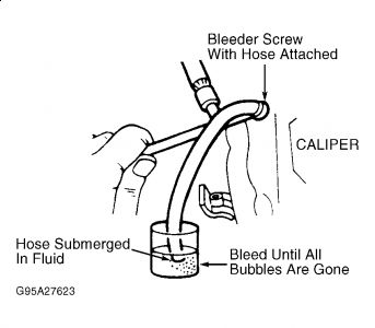

I have just changed both sets of rotors, pads, and calipers on my truck. I changed the drivers side one day and the passenger the next. The problem started after I changed the first caliper. After bleeding multiple times with good pressure, the pedal was firm, but when i start the truck the pedal is easily pushed to the floor. My rear brakes function, abs included, but no front unless i pump the pedal multiple times it will hold pressure momentarily and the front brakes will grab. I figured id change the other side and see, Well it didnt help, and now ive changed the master cylinder, bench bled, bled all 4 wheels, and still, when truck is running, no front brakes unless pumped. Is there a special trick to bleeding these ford calipers? I tried having my dad pump a few times and then crack them, i tried holding pedal and leaving bleeder open, not holding pedal with bleeder open, gravity style, and i get some air then clear fluid. even while bleeding pressure builds after 1 or 2pumps. Not sure what else to do or look at. Booster tests ok according to book, with engine off pedal gets firmer when pushed. Really at a loss and any suggestions or comments would be greatly appreciated. thanks

MANUAL BLEEDING NOTE:DO NOT allow reservoir to run dry during bleeding operation. Master Cylinder Bleeding (Bench) Support brake master cylinder body in a vise, and fill both fluid brake master cylinder reservoirs with brake fluid. Install plugs in front and rear brake outlet ports. Bleed front brake system first. Loosen plug in front brake outlet port and depress primary piston slowly to force air out of master cylinder. Tighten plug while piston is depressed or air will enter brake master cylinder. Repeat procedure until no air bubbles are present. Repeat bleeding procedure for rear brake outlet port with front brake outlet plugged. Tighten plugs and try to depress piston. Piston will not depress if all air is out of master cylinder. Master Cylinder Bleeding (On-Vehicle) Using a line wrench, remove front brake tube and master cylinder outlet rear tube from master cylinder. Install short brake tubes in master cylinder and position them so they curve into master cylinder reservoir, and ends of tubes are submerged in brake fluid. Fill master cylinder reservoir with clean brake fluid. Have an assistant pump brakes until clear, bubble-free fluid flows from both brake tubes. Remove short brake tubes and reinstall front brake tube and master cylinder inlet rear tube on master cylinder. Bleed each brake tube at master cylinder by having and assistant pump brake pedal 10 times and then hold firm pressure on brake pedal. Loosen rearmost brake tube fittings until a stream of brake fluid comes out. Have an assistant maintain pressure on brake pedal until brake tube fitting is tightened again. Repeat procedure until clear, bubble-free fluid comes out from around tube fitting. Refill master cylinder reservoir as necessary. Repeat this bleeding operation at front brake tube fittings. Gravity Bleeding Fill brake master cylinder with new brake fluid. Loosen both wheel cylinder bleeder screws and leave them open until clear brake fluid flows. Check master cylinder reservoir fluid level often and do not let it run dry. Tighten wheel cylinder bleeder screws. One at a time, loosen caliper bleeder screws. Leave bleeder screws open until clear fluid flows. Check fluid level often. Tighten caliper bleeder screws. Manual Bleeding Clean master cylinder cap and surrounding area. Remove cap. All models are equipped with dual-type master cylinder. Bleed primary and secondary systems separately. Loosen primary or secondary master cylinder hydraulic line fitting. Wrap a cloth around brakelines to absorb escaping brake fluid. Slowly push brake pedal down to force out air. With pedal fully depressed, tighten fittings to prevent air from being sucked into master cylinder when pedal is released. Release pedal. Repeat procedure until air is completely purged from master cylinder. When all air has escaped, tighten fittings with pedal down. Release pedal, and depress again. If pedal is not firm, repeat bleeding procedure. Repeat procedure at bleeder fitting on rear anti-lock brake electrohydraulic RABS valve, each wheel cylinder and caliper BLEEDING SEQUENCE Before bleeding system, remove all vacuum from power unit by depressing brake pedal several times. Bleed master cylinder first, followed in sequence by rear wheel cylinders, anti-lock system components (if equipped) and calipers All (Except Models With ABS)RR, LR, RF, LF ABS ModelsRR, LR, (1), RF, LF Bleed hydraulic control unit
