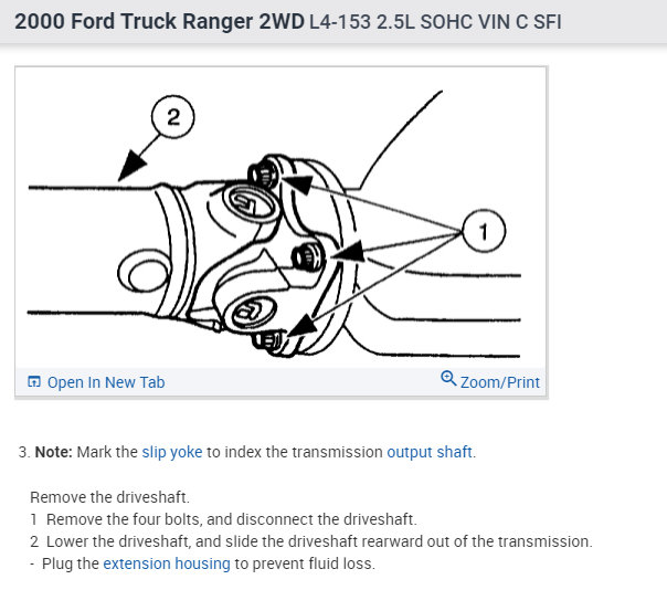

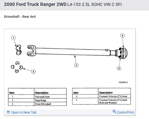

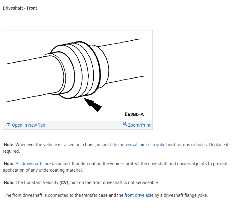

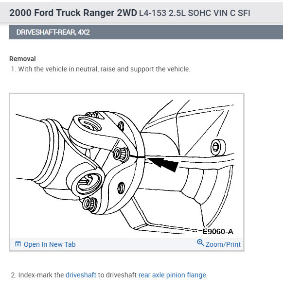

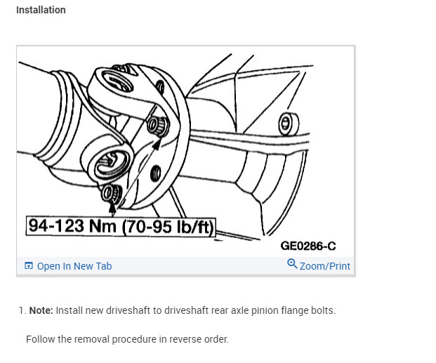

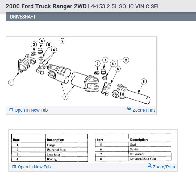

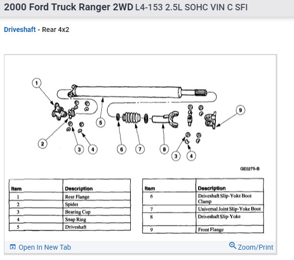

Do you pull the driveshaft on a 2000 ford ranger beginning from the front or the rear?
Monday, October 26th, 2009 AT 3:40 PM
SQM
MECHANIC
6,383 POSTS
The drive shaft can be removed starting at the rear axle pinion flange.
Here is a helpful guide:
https://www.2carpros.com/articles/how-to-remove-a-drive-shaft
I have attached the replacement procedure below.
