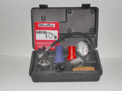

I have read in several Ranger forums where owners have gone to Autozone to borrow a pressure tester. I did the same. From 2 stored. And while each had the same two adapters none fit my radiator. I could test the radiator cap (it passed) but not the radiator. I asked the store for the correct adapter and they said this was all they had. It was a MT300 Motorad unit with a blue and chrome adapters. Am I missing something or is their equipment faulty?

I looked up the motorad mt 300 and it looks like there is 3 adapters a red one a blue one and a chrome one. See picture. They might not have the tester adapter you need with the kit. www.motoradusa.com/products/testers/index.html -The web site is

Thanks. I discovered the same thing. You would think that for a Ranger there would be a mating adapter. Is MotoRad related to Stant? I found a Stant adapter (12027) at RockAuto that looks like it will get the job done.
