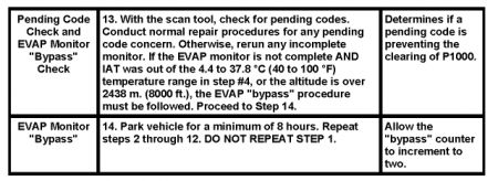

I disconnected my battery terminals to clean carosion off and then reconnected them, almost 2 weeks ago. I brought my truck in for an inspection and they told me nothing has come online yet and it should have only taken 3 heat cycles, why wont it come online?
Nov 16, 2009 at 6:56 AM
SERVICE WRITER
  • 9,123 POSTS
It depends on which monitors aren't setting.
The evap system for example needs to have the fuel tank between 1/4 and 3/4 gals of fuel. IT only runs from a cold start and takes two consectives times like this to run.
Which monitors have not run?
Nov 16, 2009 at 7:23 AM
FARMKID

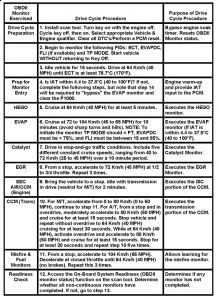

The paper work from the garage says i failed my obd because my catalyst: not ready, air system: not supported, heated 02:not ready, heated cat: unsupported, air condition: insupported, EGR: unsupported, Evap System: not ready, O2 sensor: not ready.
Nov 16, 2009 at 7:49 AM
SERVICE WRITER
  • 9,123 POSTS
try this drive cycle.
https://images.2carpros.com/forum/automotive_pictures/30961_dc_1.jpg
https://images.2carpros.com/forum/automotive_pictures/30961_dc1_1.jpg
