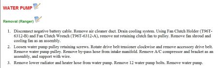

how to replace waterpump on 1999 ford ranger 3.0

https://images.2carpros.com/forum/automotive_pictures/261618_Noname_2854.jpg
https://images.2carpros.com/forum/automotive_pictures/261618_Noname2_936.jpg
