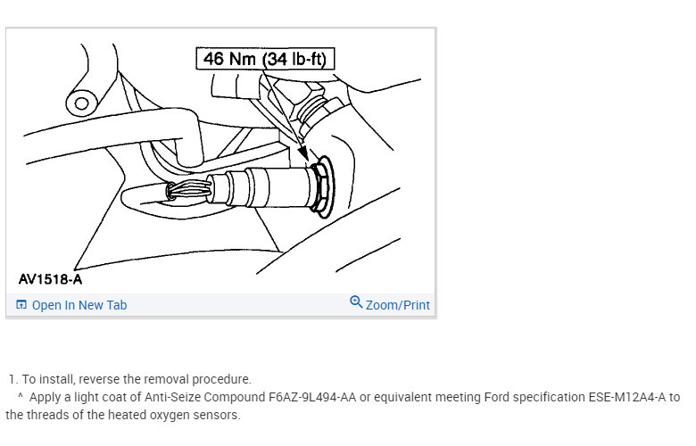

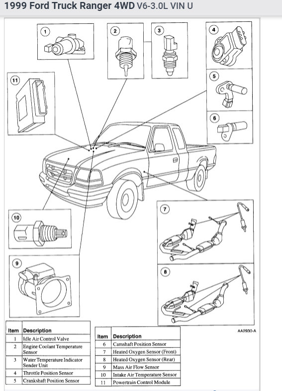

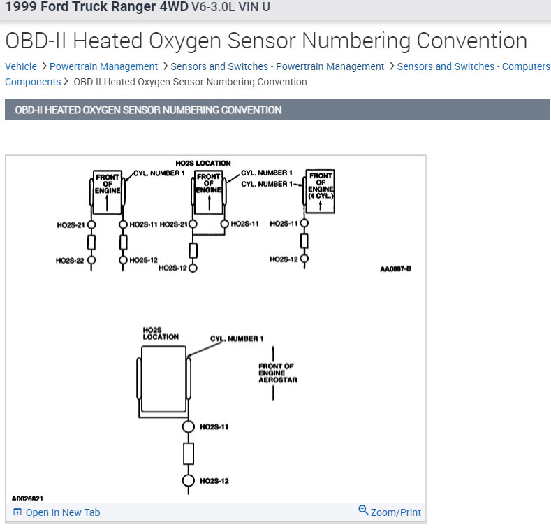

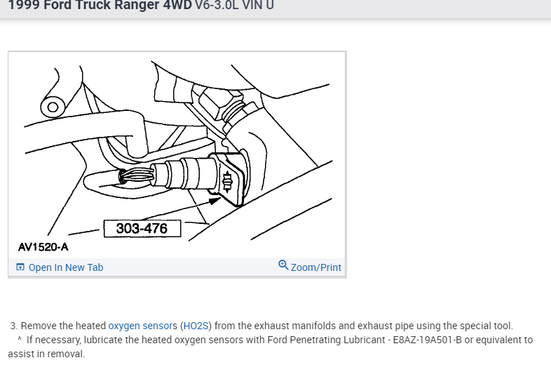

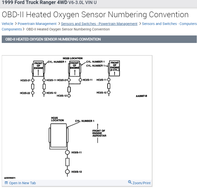

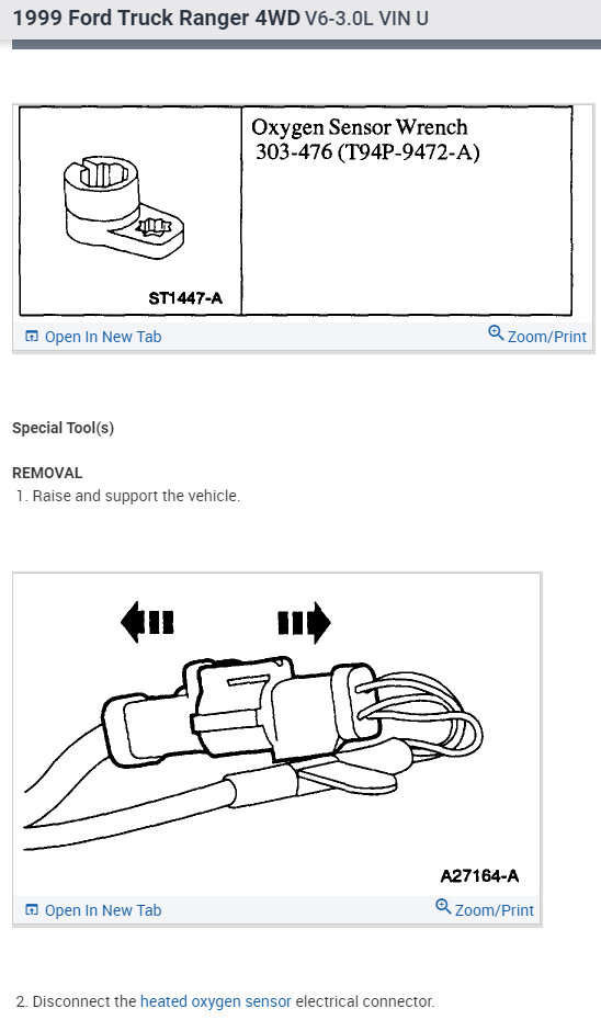

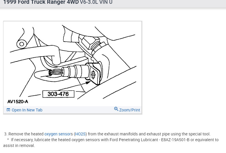

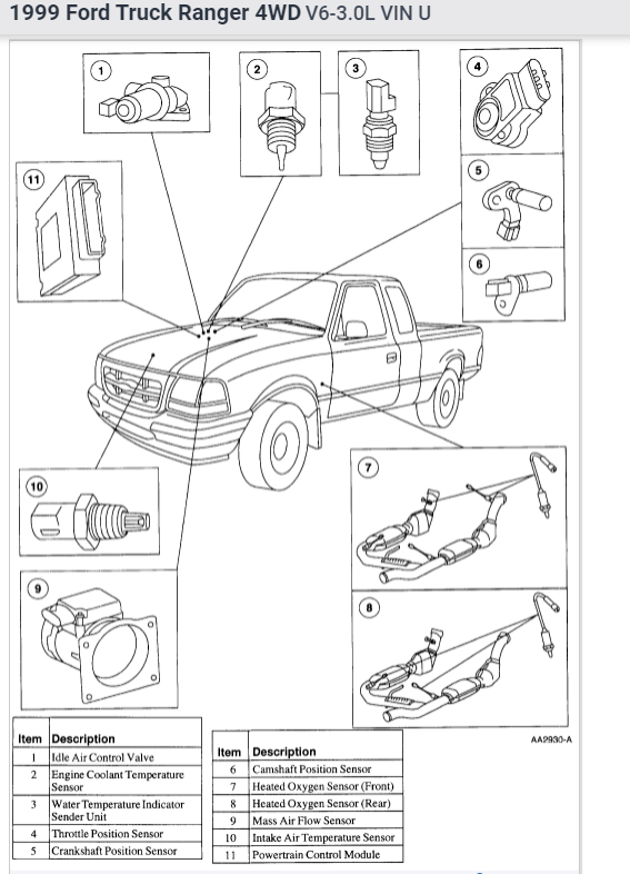

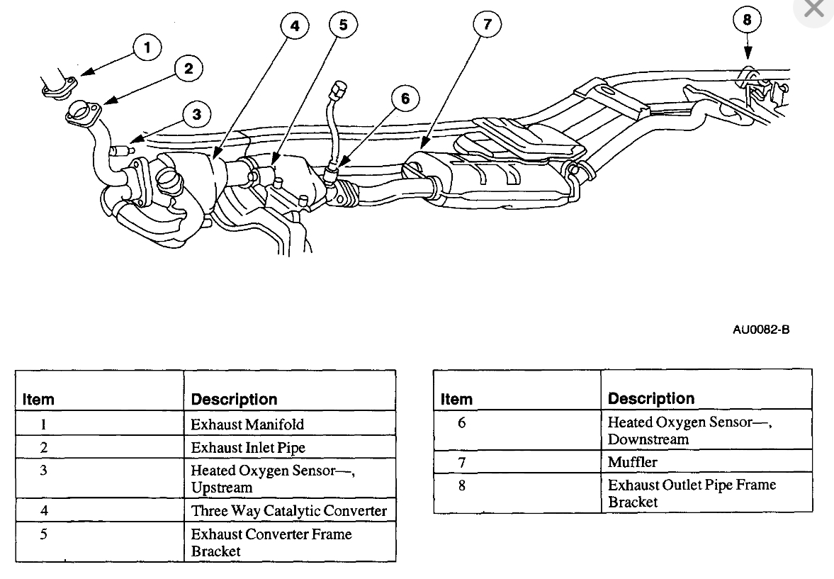

The computer output on the above vehicle indicated that "Bank 1 Sensor1" required replacement. Which sensor is that?
Friday, December 26th, 2008 AT 10:15 PM
SQM
MECHANIC
6,383 POSTS
The bank 1 sensor 1 oxygen sensor is located on the right-hand side (if you are facing the engine) exhaust manifold, before the catalytic converter.
https://www.2carpros.com/articles/how-to-test-an-oxygen-sensor-02-sensor
https://www.2carpros.com/articles/how-to-replace-an-oxygen-sensor
