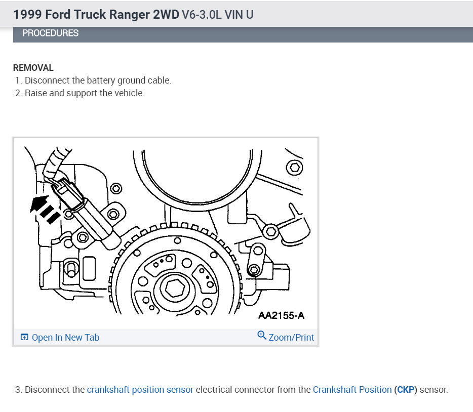

driving at 70 mph on the freeway the engine died, as I coasted to the side the engine fired again, no problems since however check engine now on, P0320
Mar 14, 2010 at 4:12 PM
  • 75,992 POSTS
P0320 Ignition/Distributor Engine Speed Input Circuit Malfunction
Set Condition: No signal from the crankshaft position sensor is present during engine cranking, and at least 3 camshaft position sensor signals have occurred. More than likely it's a CKP sensor but... in rare cases a bad CMP sensor can cause the 5V or 8V supply to collapsed, causing this condition. Here is the sensor you need to replace. Check out the diagrams (Below). Please let us know if you need anything else to get the problem fixed.
