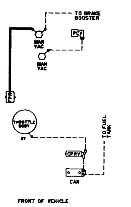

JEFFCOW
my ranger has a broken vacuum line and i need to know where it goes. i have figured out that one line goes to the purge valve and i don't know where the other one goes. please help......................................................................................
Jan 5, 2020 at 11:54 AM (Merged)
TY ANDERSON
  • 719 POSTS
Here is a vacuum diagram for the 2.3l,3.0L & 4.0L. Check out the diagrams (Below). Please let us know if you need anything else to get the problem fixed.

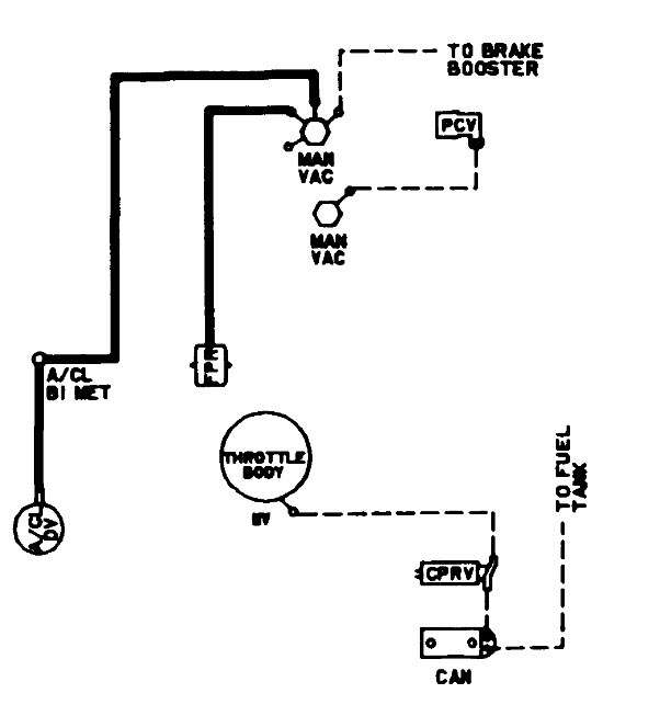

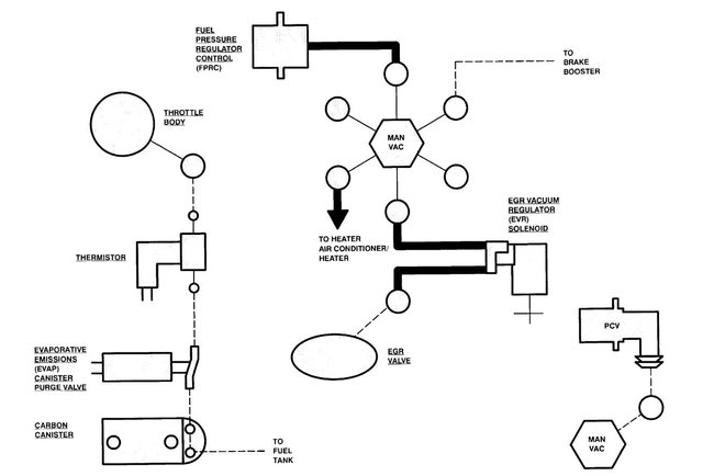

HMAC300
  • 48,601 POSTS
there are 2 different routings im sending both
Jan 5, 2020 at 11:55 AM (Merged)
HMAC300
  • 48,601 POSTS
screwed p both are the same on first reply

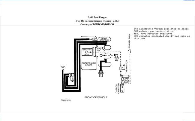

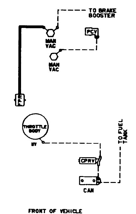

JOHN FRASER
How can I download a schematic showing the vacuum line configuration for a 1990 Ford Ranger XLT with the 4.0 engine? Where can I download a schematic drawing of the vacuum line configuration
WRENCHTECH
  • 20,760 POSTS
See if this helps
