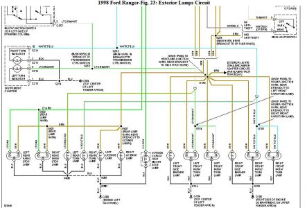

my rear tursignals do not work, My fronts do. I have chect the wiring from the bulbs back into the cab it is good, where does the wire split to go to the front and back?

https://images.2carpros.com/forum/automotive_pictures/266999_ranger_5.jpg
