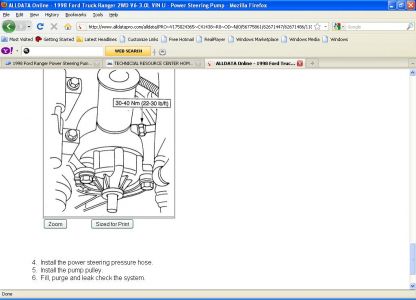

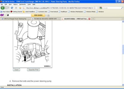

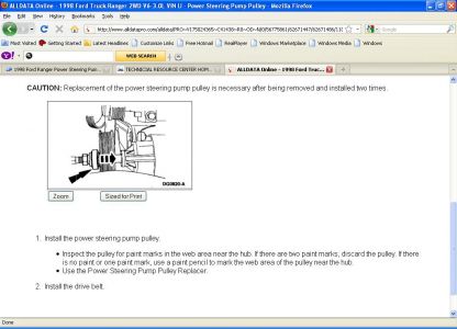

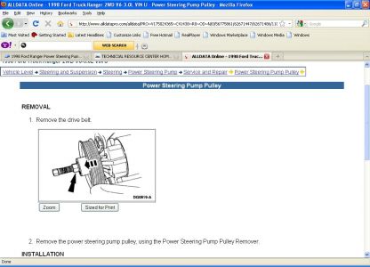

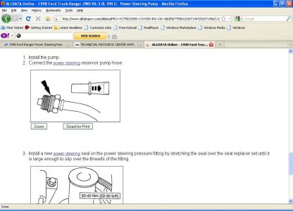

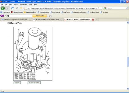

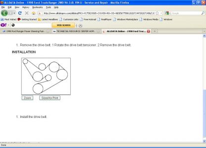

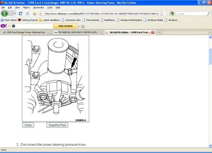

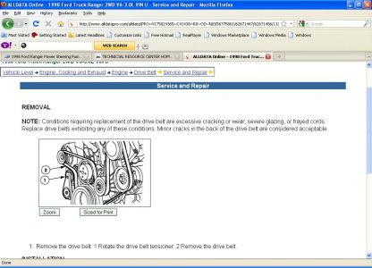

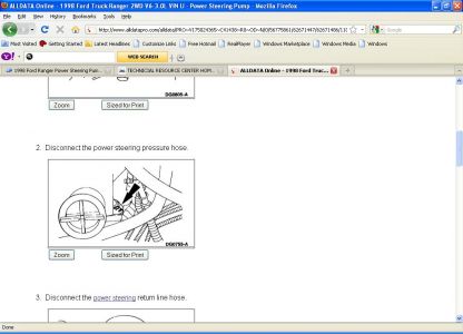

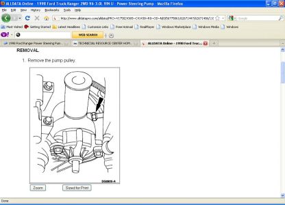

How can I remove the power steering pump? Can I remove mtg bracket and pump together? Or do I have to pull the pullery (sheave) first?
Aug 5, 2010 at 4:57 PM
SATURNTECH9
  • 30,869 POSTS
https://images.2carpros.com/forum/automotive_pictures/416332_1998_ford_ranger_3_1.jpg
https://images.2carpros.com/forum/automotive_pictures/416332_1998_ford_ranger_3_part2_1.jpg
https://images.2carpros.com/forum/automotive_pictures/416332_1998_ford_ranger_3_part3_1.jpg
https://images.2carpros.com/forum/automotive_pictures/416332_1998_ford_ranger_3_part4_1.jpg
https://images.2carpros.com/forum/automotive_pictures/416332_1998_ford_ranger_3_part5_1.jpg
https://images.2carpros.com/forum/automotive_pictures/416332_1998_ford_ranger_3_part6_1.jpg
https://images.2carpros.com/forum/automotive_pictures/416332_1998_ford_ranger_3_part7_1.jpg
https://images.2carpros.com/forum/automotive_pictures/416332_1998_ford_ranger_3_part8_1.jpg
https://images.2carpros.com/forum/automotive_pictures/416332_1998_ford_ranger_3_part9_1.jpg
https://images.2carpros.com/forum/automotive_pictures/416332_1998_ford_ranger_3_part10_1.jpg
https://images.2carpros.com/forum/automotive_pictures/416332_1998_ford_ranger_3_part11_1.jpg
I asked if you had a 3.0L engine you never answered there is two different V6 engine's a 3.0L and a 4.0L I posted the instruction's for the 3.0L i hope that's what you have.It doesn't say to drain the power steering fluid out before you take it off but you will have to do that it's a lot less messy that way.You can get one of those big red balled battery filler's to drain it.

Thanks so much, you supplied me with exactly the info I need to change the pump. I'll recommend your services to any who fixes their own cars...
