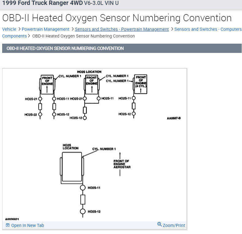

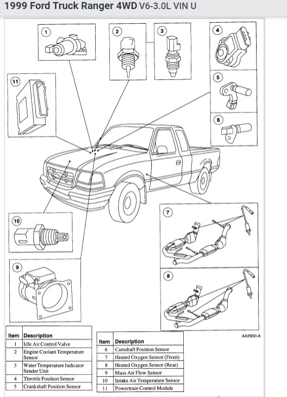

How do you locate the oxygen sensor
1998 FORD RANGER
120,000 MILES • 6 CYL • 4WD • AUTOMATIC
DKROLETTO

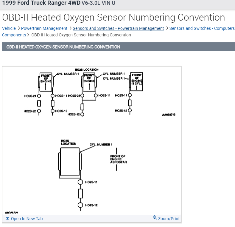

how do you locate the oxygen sensor
Jun 15, 2009 at 4:37 PM
SQM
  • 6,383 POSTS

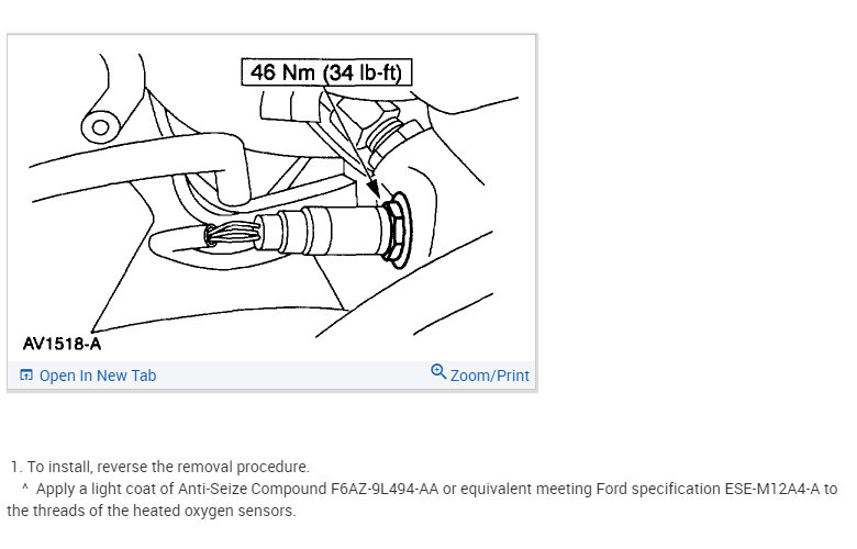

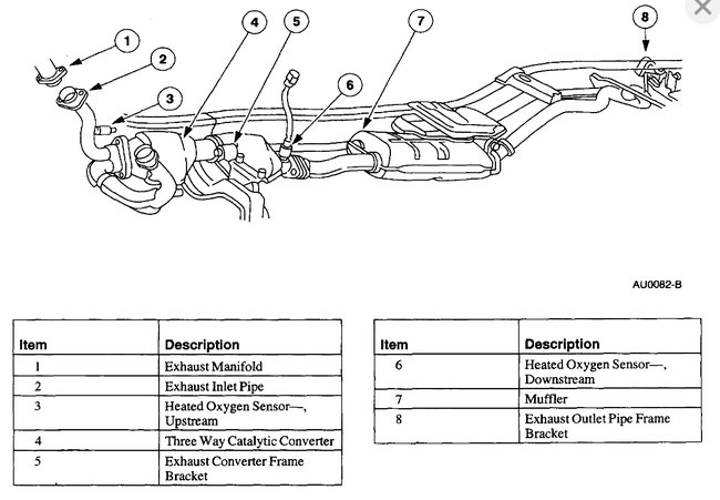

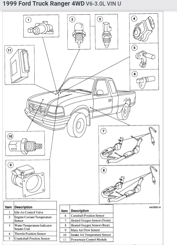

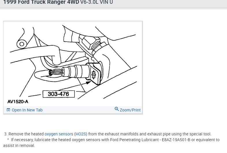

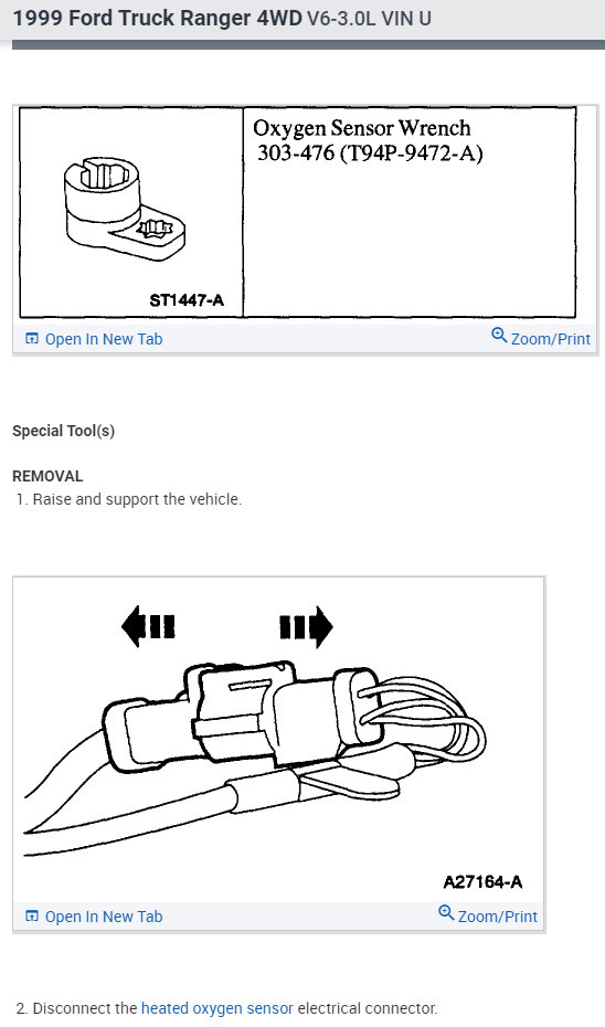

The oxygen sensors are located in the exhaust system.
There are one of each on both sides exhaust manifold. Then one of each on the exhaust pipe after the catalytic converter.
Here is a helpful video:
https://youtu.be/BVUzDz6i_bw
Also, some articles that covers the oxygen sensor replacement procedures:
https://www.2carpros.com/articles/how-an-oxygen-sensor-works
https://www.2carpros.com/articles/how-to-replace-an-oxygen-sensor
