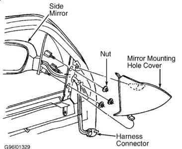

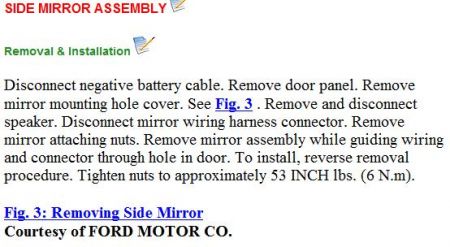

My left Mirror is almost bout ready to fall off. i want to fix it. its a electric motor powered mirror, so disassembling it is where im lost. with all those wires and electrical in the way. im afraid i might damage more if i just rip it off.
any suggestions? how should i go about this situation?

It is quite simple. Just follow the direction. The hardest part is to remove the door panel.
https://images.2carpros.com/forum/automotive_pictures/55316_98rangermirror0_1.jpg
https://images.2carpros.com/forum/automotive_pictures/55316_98rangermirror_1.jpg
