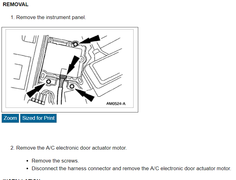

hot air continually blows even though the heater and vent are turned off
Apr 5, 2009 at 4:19 AM
RANGERDANGER17
  • 224 POSTS
It sounds like you have a temperature blend door actuator that is stuck and needs top be replaced which is common. here isa guide and guide to show you how to do the job.
