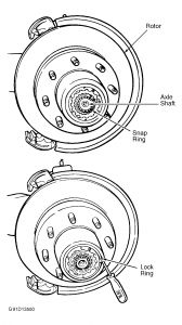

watched video on how to change front rotors and pads. great video. first timer on changing pads and rotors. followed video to a tee. for the life of me i cannot get my first rotor off? i squirted with penetrating oil let sit fo 5 minutes and tapped lightly still cannot get off? am i doing something wrong? please help? i have a ford ranger 4x4 6cyl 3.0

4X4 YOU NEED TO REMOVE THE HUB AND
https://images.2carpros.com/forum/automotive_pictures/99387_RANGER_BRAKES_1.jpg
BEARINGS
