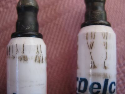

The consensus from various forums, plus the local Ford dealer in the hometown of some friends in Canada who rallied to help, was that the problem could be with any or all of the coil pack, high tension wiring harness or the plugs. Turns out it was the plugs. I replaced them and the engine runs fine.
As a side note, it appears the problem was specifically with the 3 plugs on the right side of the engine (left side if you are standing in front of the vehicle looking at the engine). The long white ceramic insulator that the cables snap onto all had dozens of small, vertical cracks in the top half. The 3 plugs on the left side of the engine appeared fine. Does anybody know what would cause such cracking/crazing and why it would only happen to the plugs on one side of the engine?
https://www.2carpros.com/forum/automotive_pictures/452942_IMG_1907_1.jpg
