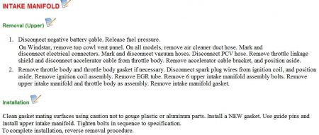

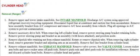

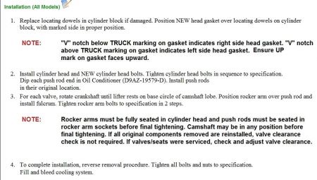

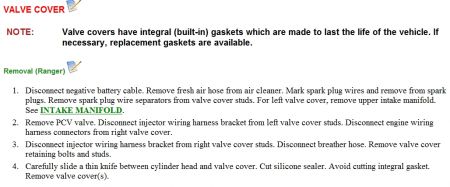

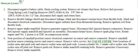

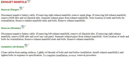

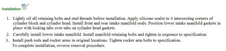

What is the proper and precise procedure to remove and replace the cylinder head(s)? This truck has A/C, power steering and usual Ford components.

Is this on the 3.0L or the 4.0L engine?

This is the 3.0 size engine.

https://images.2carpros.com/forum/automotive_pictures/261618_Noname_2766.jpg
https://images.2carpros.com/forum/automotive_pictures/261618_Noname2_898.jpg
https://images.2carpros.com/forum/automotive_pictures/261618_Noname3_325.jpg
https://images.2carpros.com/forum/automotive_pictures/261618_Noname4_146.jpg
https://images.2carpros.com/forum/automotive_pictures/261618_Noname5_62.jpg
https://images.2carpros.com/forum/automotive_pictures/261618_Noname6_28.jpg
https://images.2carpros.com/forum/automotive_pictures/261618_Noname7_13.jpg
https://images.2carpros.com/forum/automotive_pictures/261618_Noname8_9.jpg
