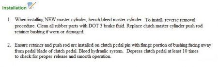

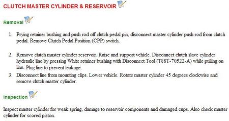

how do i replace my clutch master cylinder

https://images.2carpros.com/forum/automotive_pictures/261618_Noname_1226.jpg
https://images.2carpros.com/forum/automotive_pictures/261618_Noname2_360.jpg
