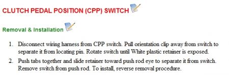

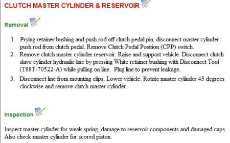

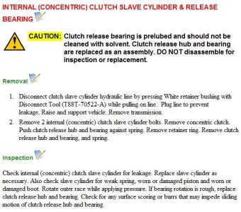

Please tell me the proper way to remove and replace the clutch master and slave cylinder. How to remove the spring loaded switch on the clutch push rod. How to disconnect the slave cylinder line to the master cylinder.

https://images.2carpros.com/forum/automotive_pictures/261618_Noname_2346.jpg
https://images.2carpros.com/forum/automotive_pictures/261618_Noname2_768.jpg

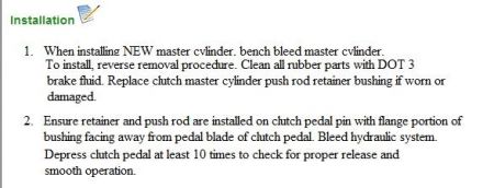

https://images.2carpros.com/forum/automotive_pictures/261618_Noname3_285.jpg
https://images.2carpros.com/forum/automotive_pictures/261618_Noname4_134.jpg
