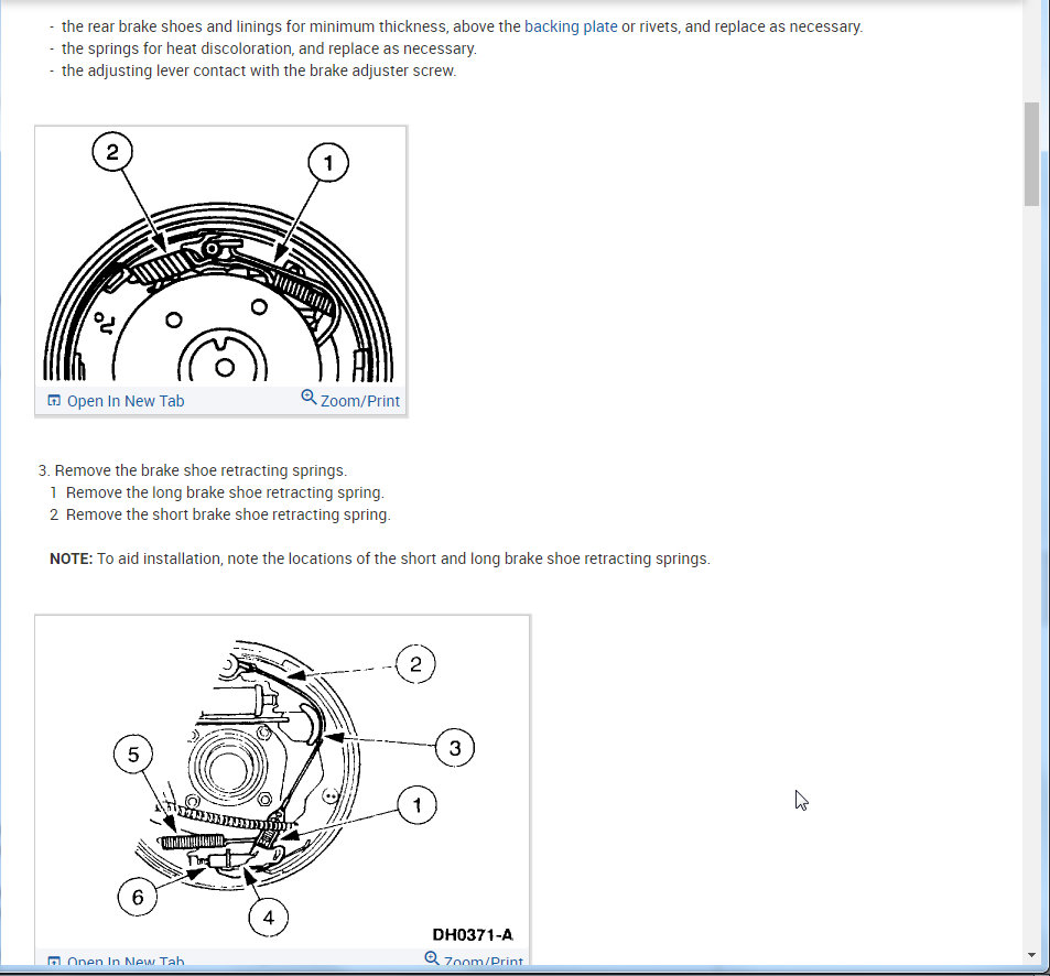

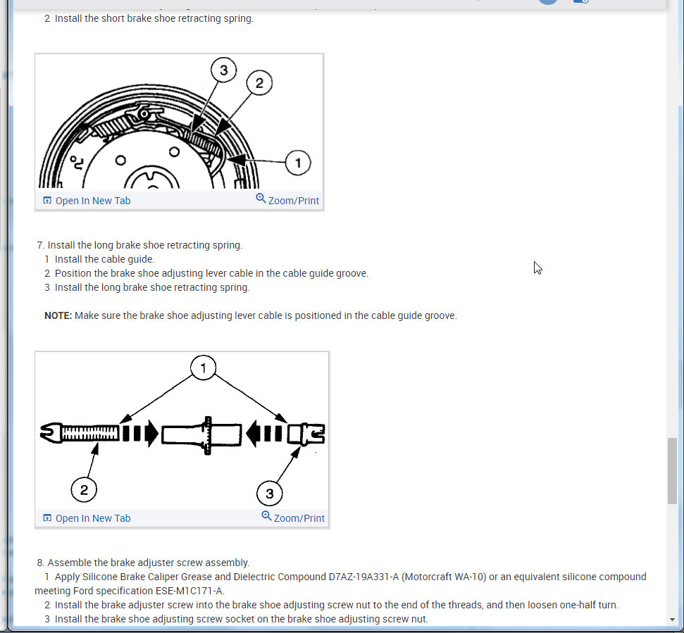

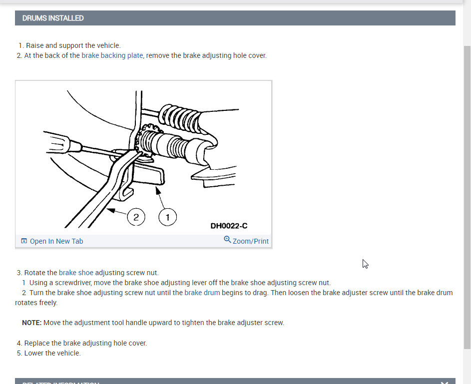

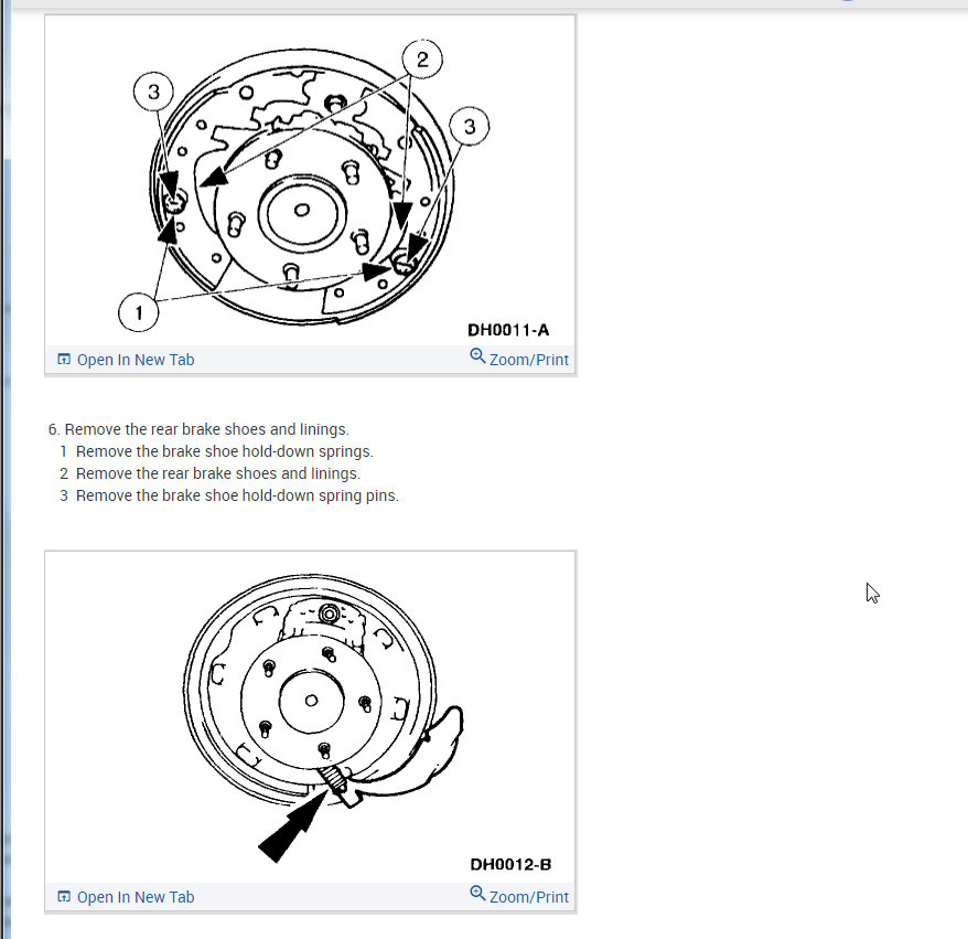

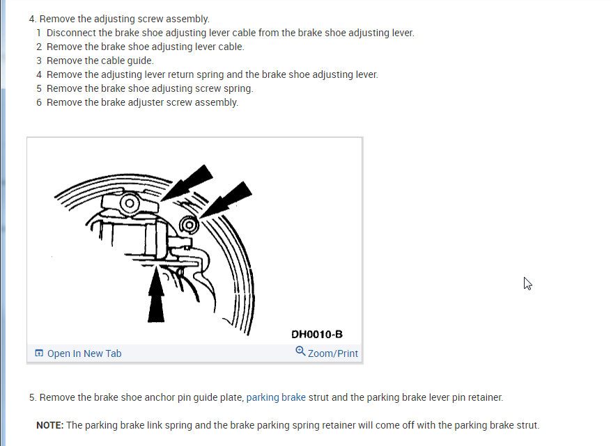

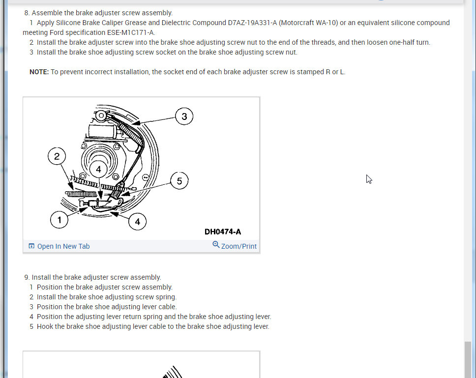

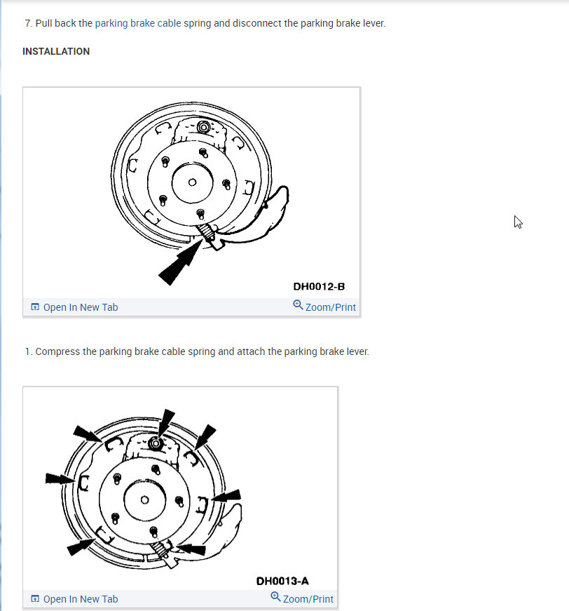

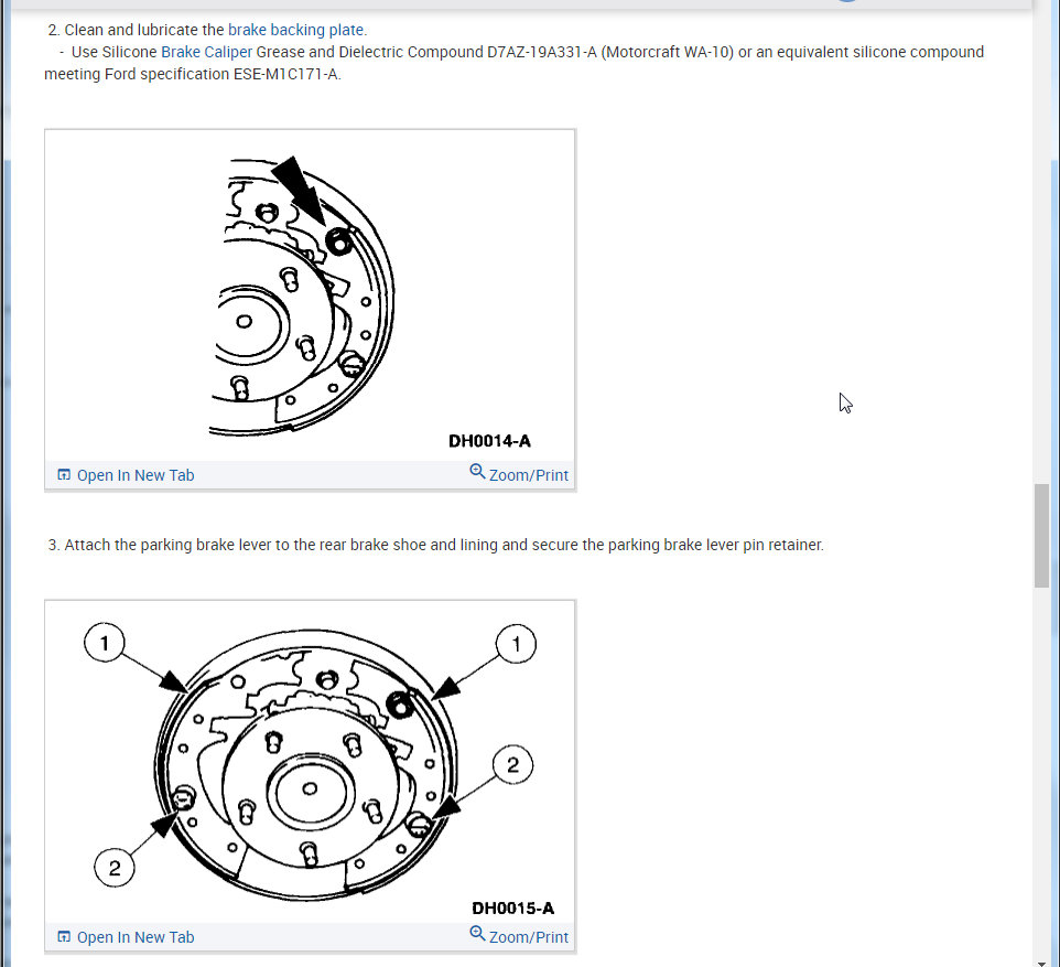

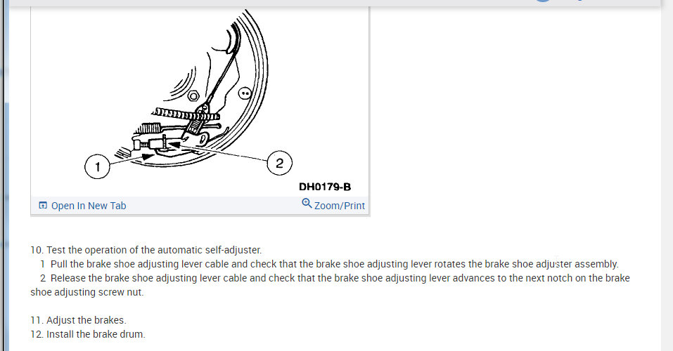

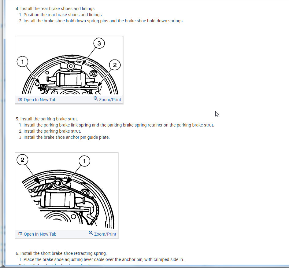

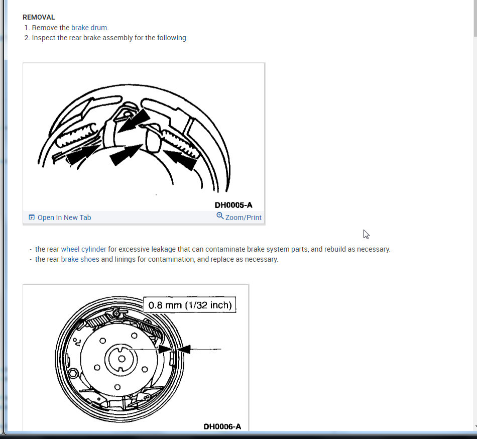

More than likely the drums are not adjusted properly. I would make sure the shoes are okay and replace them if needed and then turn or replace the drums as well.
https://www.2carpros.com/articles/how-to-replace-rear-brake-shoes-and-drums
Then reinstall everything and adjust the brakes as shown in the information below.
Please run through this material and let us know what questions you have.
