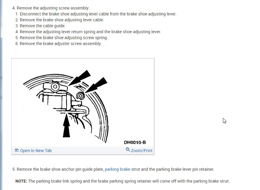

98 ford ranger brakes grabbing too much screeching tires for the first couple of stops. This happens if you apply the brakes kinda fast. After a couple of of times it goes away..
Mar 17, 2009 at 11:21 PM
SCHRIMPIEMAN
  • CAR REPAIR CONTRIBUTOR
  • 166 POSTS
Resurface the drums and purchase OEM Motorcraft brand brake shoes; then install. The friction material with Motorcraft (despite the higher cost) is more compatable and doesn't create that "grabbing" when brakes are applied.
The extra $$ for Motorcraft brake shoes is worth it.
I can say from experience... I had the same problem.
Apr 14, 2021 at 10:23 AM

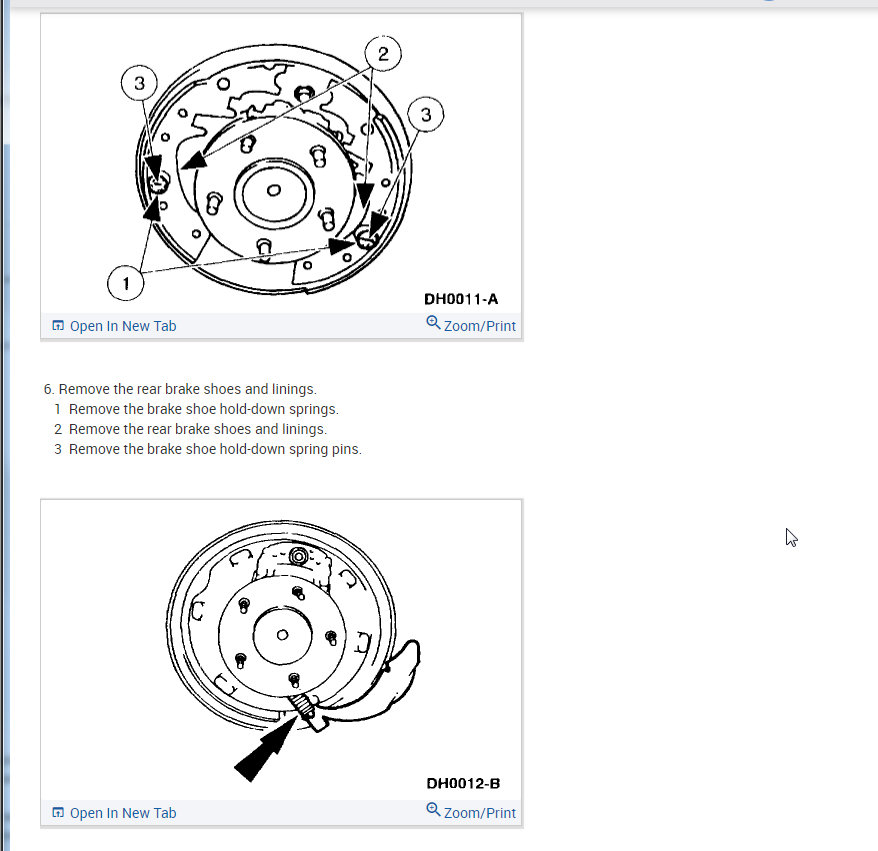

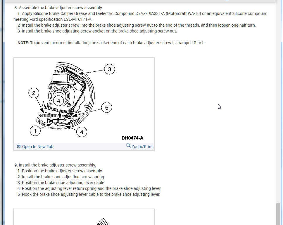

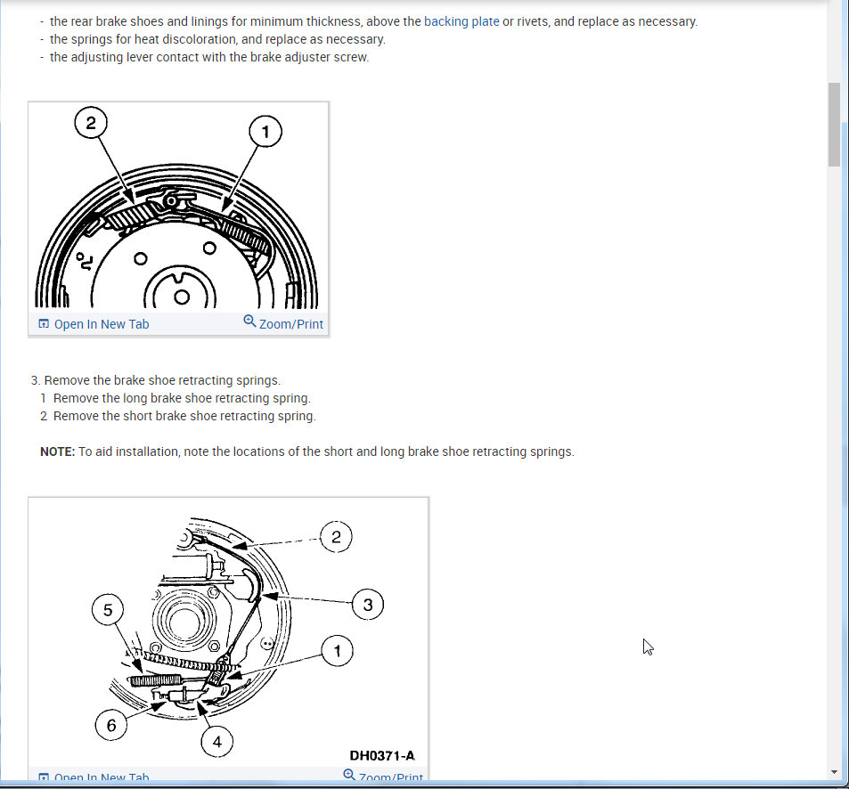

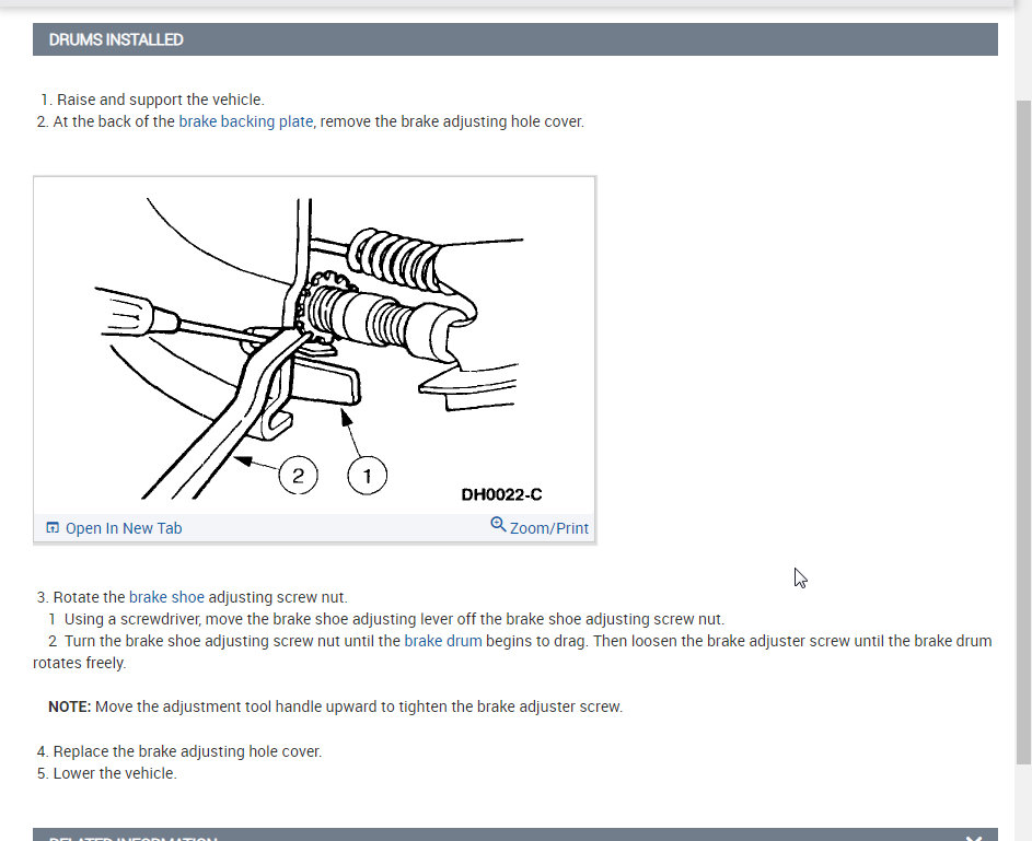

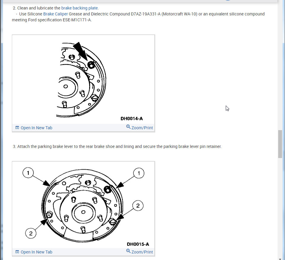

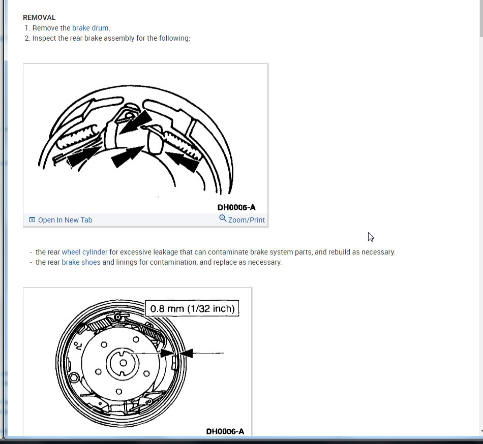

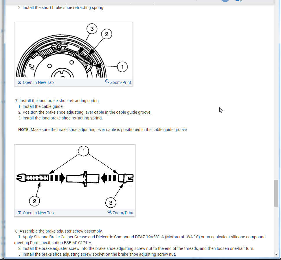

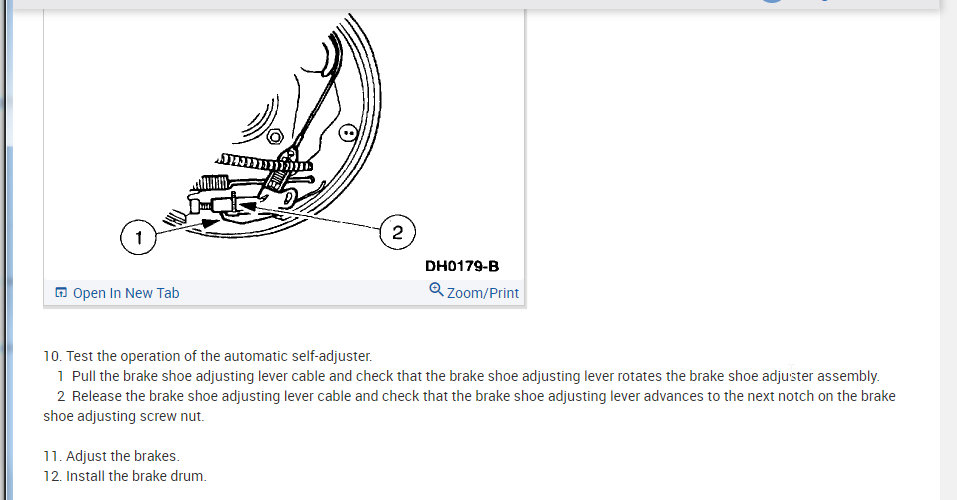

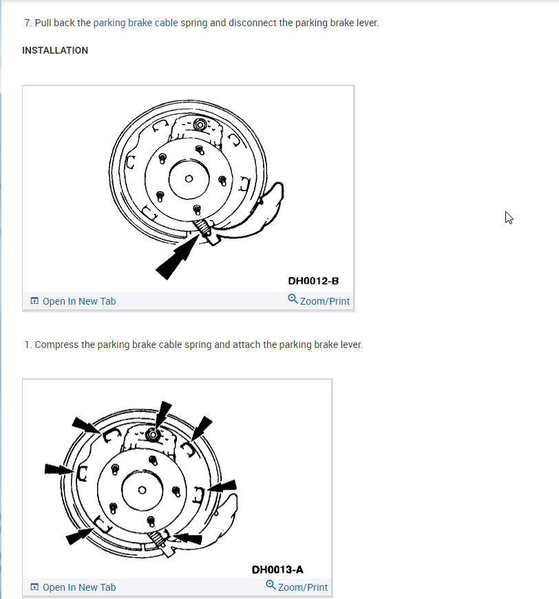

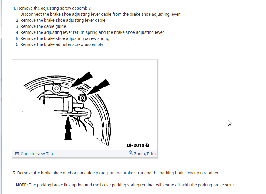

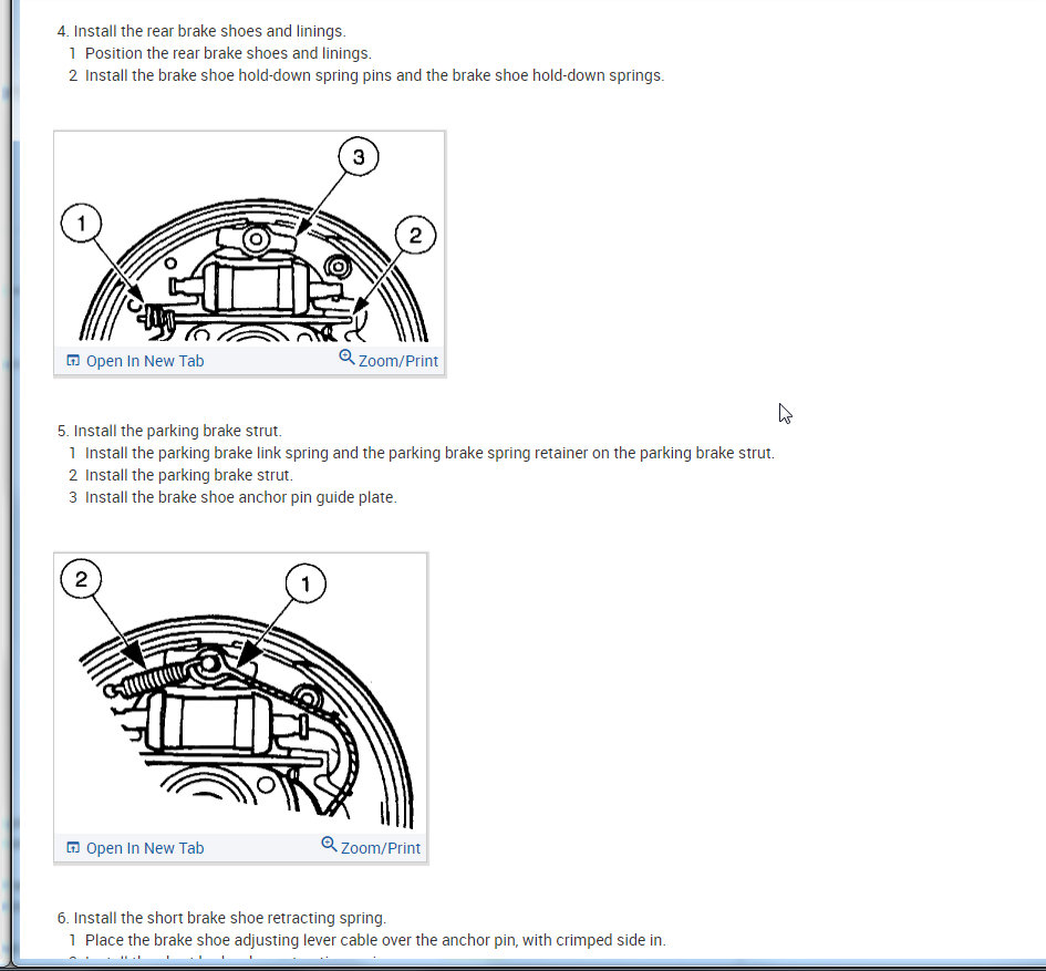

More than likely the drums are not adjusted properly. I would make sure the shoes are okay and replace them if needed and then turn or replace the drums as well.
https://www.2carpros.com/articles/how-to-replace-rear-brake-shoes-and-drums
Then reinstall everything and adjust the brakes as shown in the information below.
Please run through this material and let us know what questions you have.
