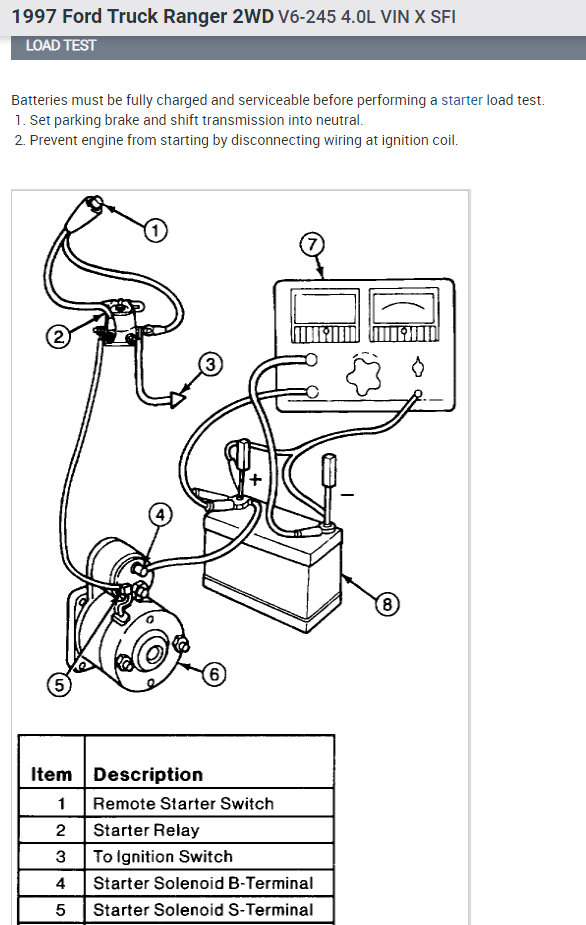

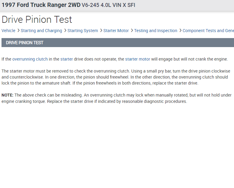

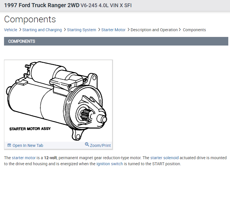

Truck battery seems find. Lights are bright everything's turns on interiorly. Truck tries to turn over, but will not. What could it be?
Thursday, July 8th, 2010 AT 6:27 PM
SQM
  • 6,383 POSTS

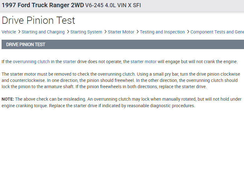

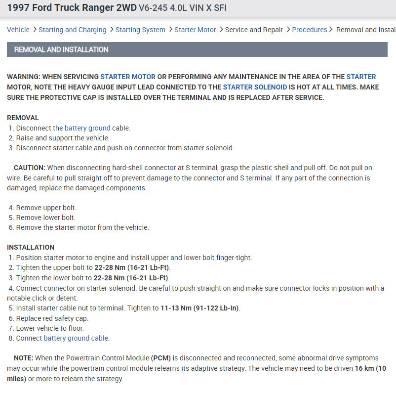

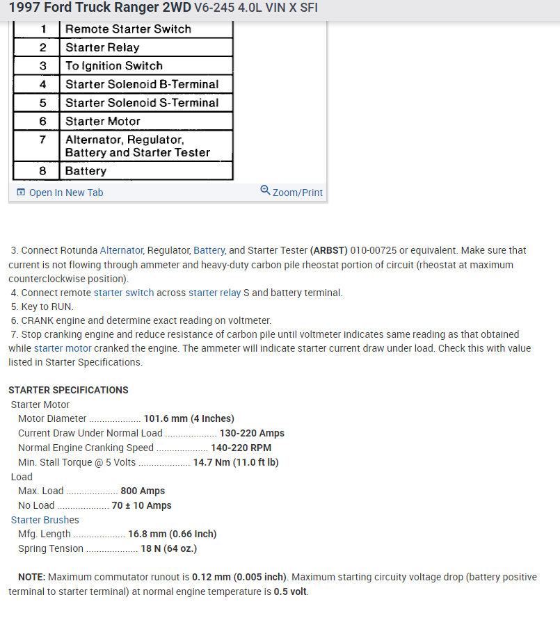

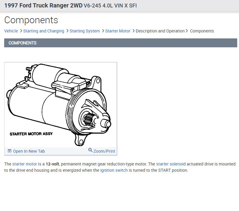

Just so we cover the basic, have you tried to jump start the vehicle?
Even though the lights are coming on, the battery might not have enough power to start the engine.
https://www.2carpros.com/articles/how-to-jump-start-car-battery-using-jumper-cables
If you try to jump start it and it still does the same thing, just barely turns over you could have a bad starter.
Now if the engine cranks over strong but does not start, it can be due to either not getting spark or fuel.
Check to see if you are getting spark.
Here is a helpful guide:
When you turn on the key can you hear the fuel pump come on? An inoperative or weak fuel pump can also keep the engine from running.
