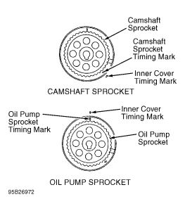

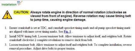

My timing belt broke I replaced it now the engine turns over and has spark but won't start Ithink I have it time but Iam not sure can you help me and if it is in time and still does not start what could it be? Can you help me?
Wednesday, February 17th, 2010 AT 8:19 PM
BLUELIGHTNIN6
  • 16,542 POSTS
Most likely just have low compression due to incorrect timing. Ensure timing belt was installed correctly and that engine is in time..
https://www.2carpros.com/forum/automotive_pictures/261618_Noname_1689.jpg
https://www.2carpros.com/forum/automotive_pictures/261618_Graphic_339.jpg
