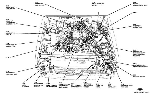

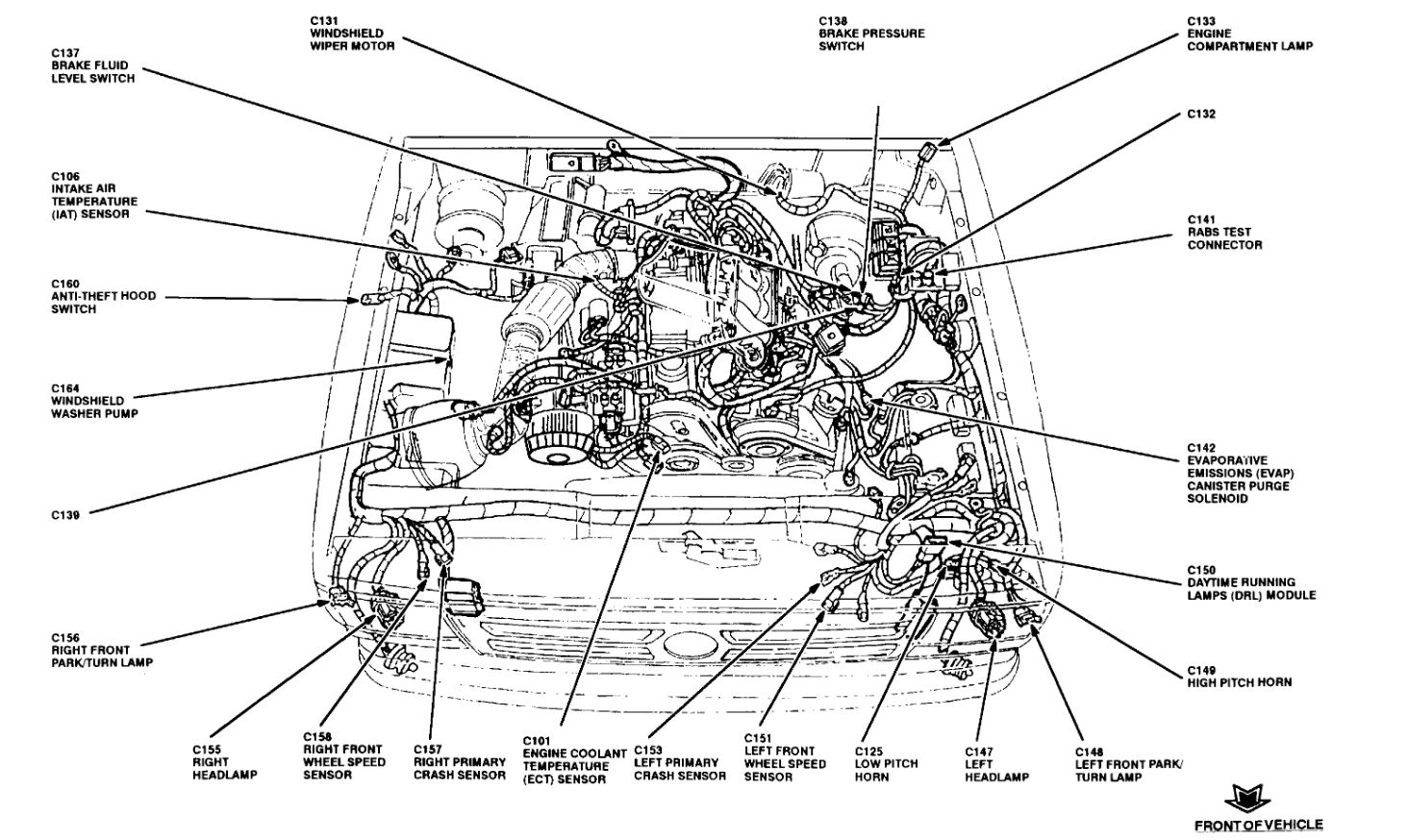

Trying to locate the coolant temperature sensor and having problems finding it. Can you please help? Where do I locate the sensor and how do I change it?
Dec 20, 2008 at 8:06 AM
  • 75,988 POSTS
See below On top right front of engine, in water outlet tube See the diagram below for location

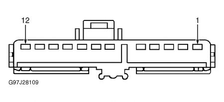

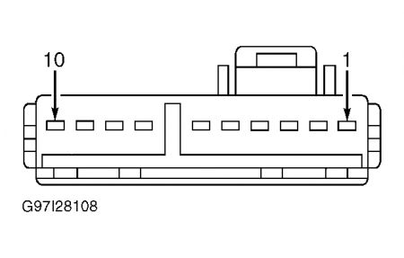

Hello again.. could you please use the reply button at the bottom of this box .. not open another box .. it's pure luck i spotted your name in the list .. if you use the reply button it tells me you have replied !! thanks COOLANT TEMPERATURE READS INACCURATELY (RANGER) Perform TEMPERATURE GAUGE TEST under COMPONENT TESTS. If temperature gauge perform properly, replace temperature sensor and retest system. If temperature gauge does not perform properly, go to next step. Turn ignition off. Disconnect temperature sensor harness connector. Remove instrument cluster. See INSTRUMENT CLUSTER under REMOVAL & INSTALLATION. Disconnect instrument cluster connector C215. See Fig. 3 . Measure resistance of Red/White wire between instrument cluster connector C215, terminal No. 3 and temperature sensor harness connector. Resistance should be less than 5 ohms. Measure resistance between ground and instrument cluster connector C215, terminal No. 3 (Red/White wire). Resistance should be more than 10 k/ohms. If resistance is as specified, go to next step. If resistance is not as specified, repair open or short in Red/White wire and retest system. Disconnect instrument cluster connector C216. See Fig. 4 . Turn ignition on. Measure voltage between ground and instrument cluster connector C216, terminal No. 1 (Red/Yellow wire). If voltage is more than 10 volts, go to next step. If voltage is less than 10 volts, repair open in Red/Yellow wire between instrument cluster connector and fuse No. 11 in interior fuse panel and retest system. Turn ignition off. Measure resistance between ground and instrument cluster connector C215, terminal No. 2 (Black/White wire). If resistance is less than 5 ohms, go to next step. If resistance is more than 5 ohms, repair open in Black/White wire between instrument cluster connector and ground and retest system. Measure resistance between instrument cluster temperature gauge clips "B" and "S". Resistance should be 215-256 ohms. Measure resistance between instrument cluster temperature gauge clips "G" and "S". Resistance should be 90-110 ohms. If resistances are as specified, replace instrument cluster printed circuit and retest system. See PRINTED CIRCUIT (RANGER) under REMOVAL & INSTALLATION. If resistances are not as specified, replace temperature gauge and retest system. See GAUGES under REMOVAL & INSTALLATION. 3)

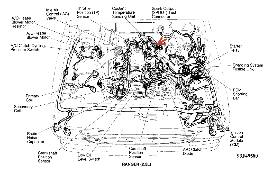

Got a code for ect sensor on my 93 Ranger 2.3 4 cyl but can't find its location. Repair manual says in thermostat housing but its not.Can you tell me where it is?
Oct 31, 2020 at 4:00 AM (Merged)
HMAC300
  • 48,601 POSTS
its on the right friont of engine on coolant line pic i have sent ishows temp sender. sensor is on right front coolant line
