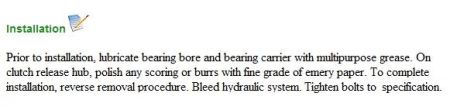

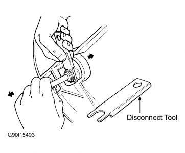

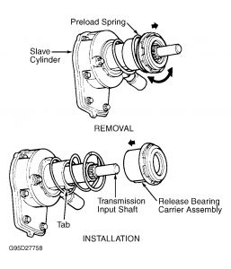

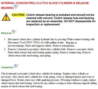

Where can I get info about this subject?
