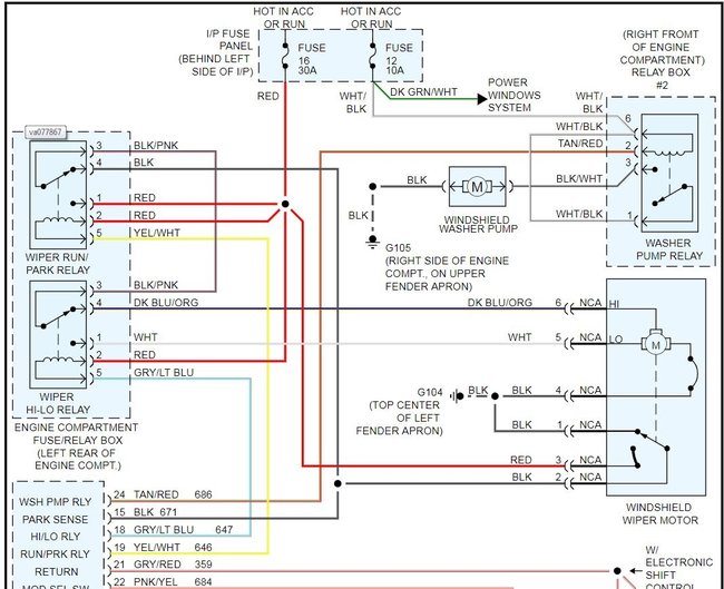

wipers quit Smelled something electrical cook. Replaced motor and burned out fuse. I have no power to new motor. Is there a relay somewhere that cooked? I unfortunately don't have an owners manual or schematic of system. Any help before it rains or snows would be great.

Wiper Hi-Lo Relay...In engine compartment fuse/relay box. Wiper Run/Park Relay...In engine compartment fuse/relay box.
https://images.2carpros.com/forum/automotive_pictures/266999_wiper_3.jpg

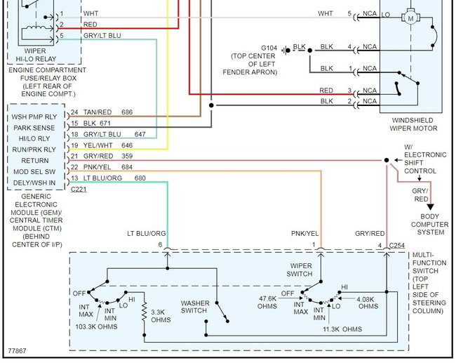

If you smelled burnt wiring, I would check where it goes into the steering column first, may have rubbed through Attached below are the wiring diagrams for your wipers

I have replaced the smart switch and have checked the fuses but the wipers only work spasmatically. I have been playing with wires under the hood and it seems to have helped some but when I crank it up they quit working for a bit

Did you replace the wiper switch on the column? It is a known issue with these trucks.
