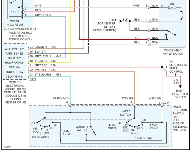

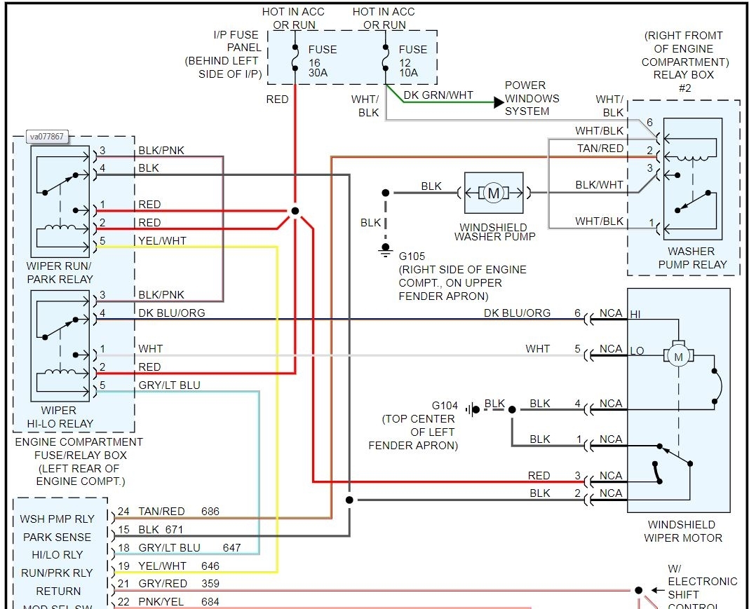

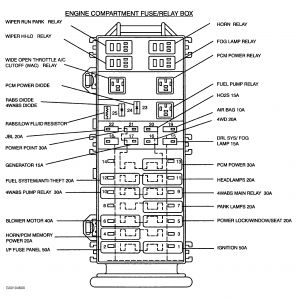

wipers quit Smelled something electrical cook. Replaced motor and burned out fuse. I have no power to new motor. Is there a relay somewhere that cooked? I unfortunately don't have an owners manual or schematic of system. Any help before it rains or snows would be great.

Wiper Hi-Lo Relay...In engine compartment fuse/relay box.
Wiper Run/Park Relay...In engine compartment fuse/relay box.
https://www.2carpros.com/forum/automotive_pictures/266999_wiper_3.jpg
If you smelled burnt wiring, I would check where it goes into the steering column first, may have rubbed through
Attached below are the wiring diagrams for your wipers
