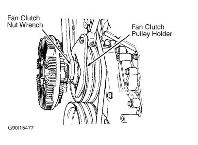

The water pump on my ranger started to leak real bad, so I bought a new water pump and rented the tool to pull it off, can you please inform me on the procedure or the steps to taking it off. Thank You Very Much

Remove negative battery cable drain coolant system disconnect lower radiator hose and heater return hose from water pump using clutch fan holder and fan wrench remove radiator fan and clutch assembly
https://images.2carpros.com/forum/automotive_pictures/99387_clutch_fan_1.jpg
Remove drive belt remove alternator and bracket remove pulley and then water pump
