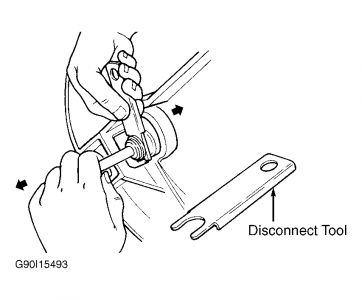

I can't get the hydraulic fitting to go back into the slave cylinder.

Internally Mounted Slave Cylinder
Using Disconnect Tool (T88T-70522-A), disconnect coupling at transmission by lightly tugging on clutch tube while sliding White plastic sleeve toward slave cylinder. See Fig. 5 . Clean area around reservoir cap. Fill reservoir with DOT 3 brake fluid. Using hand pressure, apply 10-15 pounds to clutch pedal. If pedal is hard, go to step 3). If pedal is spongy, go to next step.

Test system operation by starting vehicle, depressing clutch and placing gearshift in Reverse. No grinding should be heard or felt when clutch pedal is within 1/2" (13 mm) of floor. If noise is heard, check for air in system. Repeat bleeding procedure if necessary. You may need to lubricate the line with brake fluid when installing it back into the slave cylinder to get it to go in
