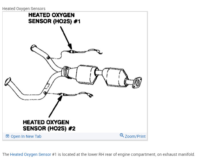

We are trying to locate where the oxygen sensors are located on the Ford Ranger. We think they are bad and want to replace ourselves to save some money.
Thank you,
Lynn
Oct 10, 2009 at 5:50 AM
SQM
  • 6,383 POSTS

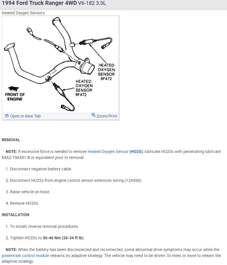

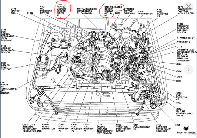

The oxygen sensors are located on the exhaust pipe right after the exhaust manifold (see diagram below).
These can be changed very easily using a oxygen sensor socket. It is a good idea to use penetrating oil before removal of the sensors as they are likely seized on the exhaust.
