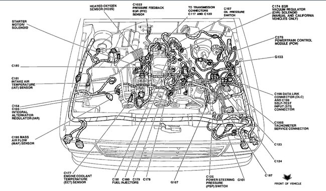

where is the computer located at (ecc) and how do you know if its going bad???????????
Aug 27, 2010 at 7:51 AM
  • 75,992 POSTS
The Powertrain Control Module (PCM) is located at the LH rear corner of engine compartment.
It depends on,what the problem is.
See diagram below for location

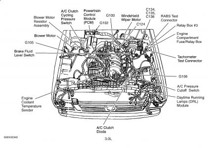

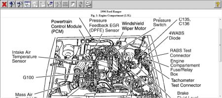

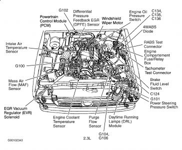

where can i find the computer box on my ranger and how do i remove it.
Aug 4, 2019 at 4:49 AM (Merged)
BMRFIXIT
  • 19,053 POSTS
Right rear of engine compartment, through firewall
https://images.2carpros.com/forum/automotive_pictures/99387_Graphic1_361.jpg
https://images.2carpros.com/forum/automotive_pictures/99387_Graphic2_167.jpg

  • 75,992 POSTS
Right rear of engine compartment, thru the firewall
