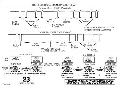

how do you jump the diagnostic connector to retrieve stored codes through the malfunction indicator lamp

KOEO & KOER SELF-TEST Codes All service codes are 2- or 3-digit numbers. PCM outputs codes one digit at a time. These codes indicate current faults in system and should be serviced in order of appearance. Codes are shown as voltage pulses. If using MIL/CHECK ENGINE light, service codes are displayed as light pulses. If using Volt-Ohmmeter (VOM), service codes are displayed as needle sweeps. See Fig. Pay careful attention to length of pauses in order to read codes correctly. A 1/2-second pause occurs between number of sweeps in a digit and a 2-second pause occurs between digits in a code. A 4-second pause occurs between each code. KOEO codes are separated from Continuous Memory Codes by a 6-second delay, a single 1/2-second sweep (Separator) and another 6-second delay. Record codes in order received. Scan tester, if used, will count pulses and display them as a digital code. Star Series Tester will add a zero (0 ) to single-digit Separator Code (10) and Dynamic Response Code (10). Dynamic Response Code is displayed in KOER SELF-TEST.
