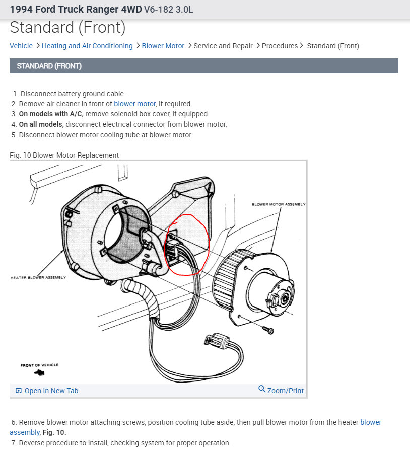

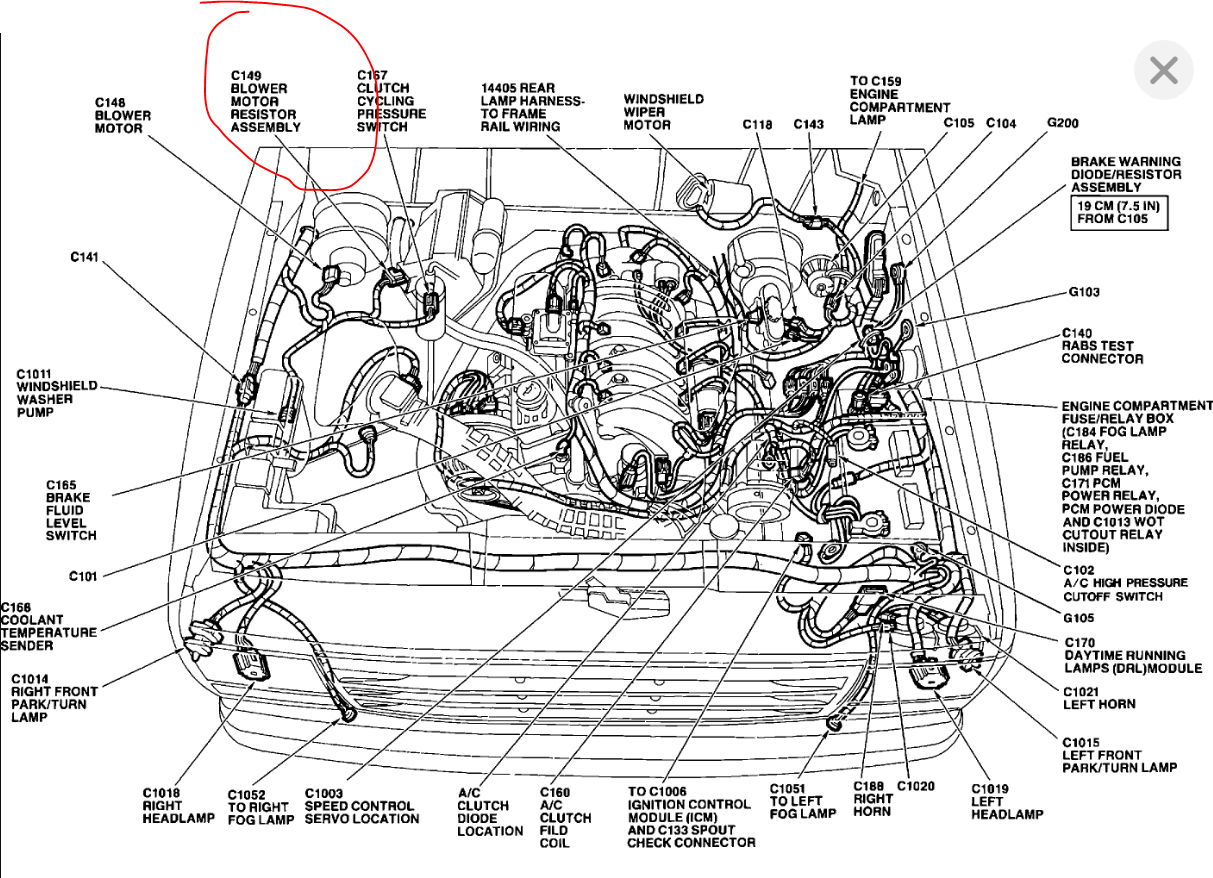

blower only blows on high, could the resistor be bad?If so, where is it located?
Jan 14, 2010 at 2:30 AM
SQM
  • 6,383 POSTS
Typically, when the resistor goes bad it will only allow one speed for the fan to operate.
The blower motor resistor is located on the passenger side fire wall, next to the blower motor (see diagram).
Simply remove the wiring harness and two bolts that keeps it in place, to remove it out of the vehicle.
