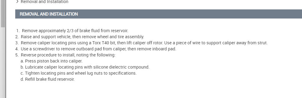

how do i remove the caliper so that i can change my brake pads , unlike most that have two caliper bolts there do not have any bolts at all, there is a clip that goes trough but i cant figure out how to remove it

I am attaching the process from the manual below but here is a guide that will help with this because the manual is not extremely detailed.
https://www.2carpros.com/articles/brake-caliper-replacement
Below you will find the process from the manual that will help with removing this. Basically, you have torx screws and not regular bolts.
Please run through this and let me know what questions you have on this. Thanks
