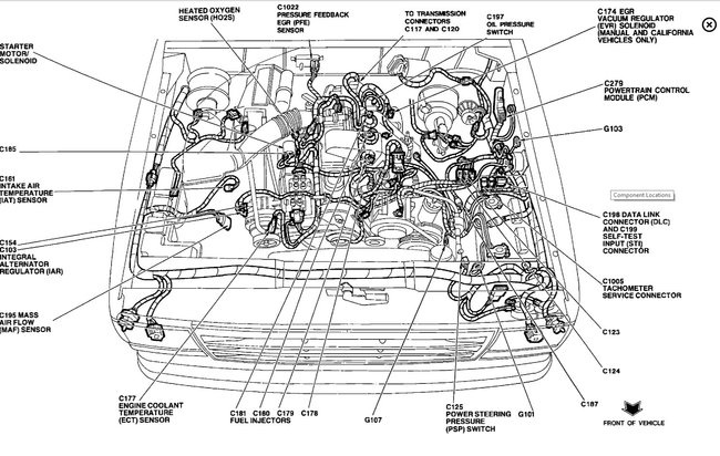

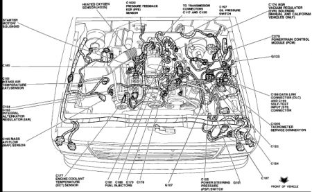

I want to know where i can hook a code scanner for a "CHECK ENGINE" light?

Hello, The ALDL data link connector is located under the hood on the drivers side under a small black cover or on the passengers side on some models. Here is how to get the codes. https://www.2carpros.com/articles/ford-lincoln-mercury-obd1-1995-and-earlier-diagnostic-trouble-code-definition-and-retrieval Please let me know if you need anything else to get the problem fixed. Best, Ken
https://images.2carpros.com/forum/automotive_pictures/12900_dc_4.jpg
LARGER IMAGE BELOW
