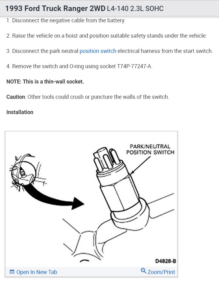

I need to bypass the neutral safety switch
HCAMPBELL256
  • 1993 FORD RANGER
  • 6 CYL
  • 2WD
  • MANUAL
  • 90,000 MILES

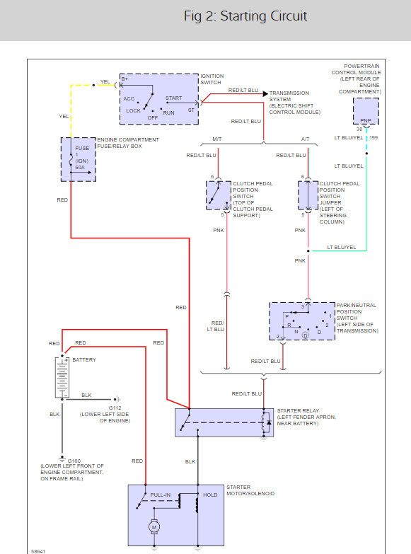

My truck broke down 1/2 mile from house and I need to bypass the neutral safety switch in order to start the vehicle and get it home for repairs. I need to know which wires to jump together to bypass the switch. There are a total of five whires on the plug but I am unable to find information on which wires to jump off of in order to get the truck started and get it home to repair my problems. Any help would be greatly appreciated!

Here is the location of the neutral safety switch and the wiring diagrams to show you how to bypass the switch below. Connect the pink and red with light blue wires. Check out the diagrams (Below). Please let us know if you need anything else to get the problem fixed.
