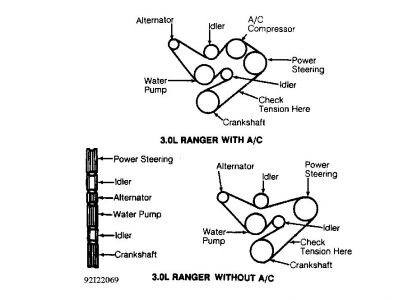

Engine Performance problem 6 cyl Two Wheel Drive Manual 89000 miles
i bought a serpentine belt but the diagram does not match my model i was wondering where can i get the actual document or picture of this model thank you.

Here is a guide and the diagrams to help you get the belts changed out in no time. https://www.2carpros.com/articles/replace-serpentine-belt and https://www.2carpros.com/diagrams/ford/ranger/1993
https://images.2carpros.com/forum/automotive_pictures/30961_ranbelt_1.jpg
Here is a the belt on Amazon for $17.00 https://www.amazon.com/gp/product/B000C36BIU/ref=as_li_qf_sp_asin_il_tl?ie=UTF8&tag=2carprcom-20&camp=1789&creative=9325&linkCode=as2&creativeASIN=B000C36BIU&linkId=fc4a19c6f723a6776a521b3645008e3a Please let us know if you need anything else to get the problem fixed. Cheers, Ken
