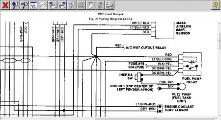

Razmataz suggested running power directly from battery to fuel pump to check if the fuel pump was bad. Any directions on how to do this would be appreciated. Thanks.

From the battery positive post straight to the pink and black wire at the fuel pump connector this will power the fuel pump
https://www.2carpros.com/forum/automotive_pictures/12900_93_ranger_1.jpg
