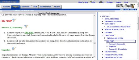

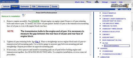

Replace an oil pump
Wednesday, January 28th, 2009 AT 7:53 PM
MECHANIC
75,992 POSTS
See below
