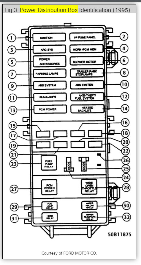

Here is the relay location with a guide to help test it. https://www.2carpros.com/articles/how-to-check-an-electrical-relay-and-wiring-control-circuit
https://images.2carpros.com/forum/automotive_pictures/12900_ranger_3.jpg
Check out the diagrams (Below). Please let us know what you find. We are interested to see what it is.

check for a set or faulty inertia switch, located under right side of dash below the glove box

The black and yellow wire is shorted to the dark green and yellow within the fuel pump relay wiring
Pull the fuse no.1 in the power distribution box this will caused it to stop which is the black and yellow wire that powers the relay

My info showed under the hood passenger side.
https://images.2carpros.com/forum/automotive_pictures/512072_ranger_fuel_pump_relay_1.jpg

https://images.2carpros.com/forum/automotive_pictures/12900_fp_12.gif
