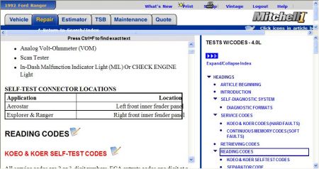

obd port location?
1992 FORD RANGER
123,000 MILES • 4 CYL • 2WD • MANUAL
DWALL199
My check engine light has come on and has significantly lost power. I went to autozone and they could not find where plug the key in to get the code. I thought it was fixed a while back when I got on the interstate and it went off and went back to normal. Then it came back on. I am completely lost on this. Please help.

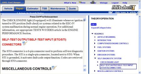

See below self test out/in and location of the connector
https://images.2carpros.com/forum/automotive_pictures/12900_stoa_1.jpg
https://images.2carpros.com/forum/automotive_pictures/12900_sto_2.jpg
