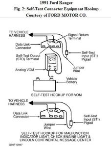

My 91 Ranger runs great, then in no preditcable way, starts hestitaing, jerking and stalling. You can recover by clutching in, revving up the engine, and restarting. When it goes into this mode, the engine light also comes on. Just today I drove 30 minutes it was fine, idling fine, running fine, no engine light. Then I stop at the parts store and when I got back in, engine light, stalling and hestitating for the next 3o minutes. After changing the fuel filter, the check engine light doesnt come back on and it runs OK. I also looked at the plug wires that appear to need changing, if nothing else but from age. Of course this is the pattern of problem/no problem. The only thing that is consistant is when the engine is acting up, the check engine light is on, and ther reverse is true. No light, runs fine.
What has me stumped is the inconsitant behavior.

Frst thing we need to do is find out what codes the CEL/PCM is displaying when the fault occurs follow the procedures below and let me know !!

SELF-TEST CONNECTOR LOCATIONS
ApplicationLocation
AerostarLeft front inner fender panel
Explorer, Navajo & RangerRight front inner fender panel

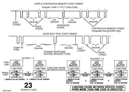

KOEO & KOER SELF-TEST CODES
All service codes are 2 or 3-digit numbers. Codes are outputted, one digit at a time, by ECA. See appropriate chart under CODE-TO-TEST MENU(S) for definitions of codes. These codes indicate current faults in the system, and should be serviced in the order of appearance. Use appropriate chart under CODE-TO-TEST MENU(S) to find the correct CIRCUIT TEST. Codes are shown as voltage pulses (needle sweeps) on an analog Volt/Ohmmeter (VOM). See Fig. 1 .
If using VOM, pay careful attention to the length of pauses in order to read codes correctly. There is a 1/2-second pause between number of sweeps in a digit, and a 2-second pause between the digits in a code. There is a 4-second pause between each code. KOEO codes are separated from Continuous Memory codes by a 6-second delay, a single 1/2-second sweep (Separator) and another 6-second delay. Record codes in the order received.
If using "Scan" Tool, it will count the pulses and display them as a digital code. The STAR Series Tester will add a zero (0) to single-digit Separator Code (10) and Dynamic Response Code (10). The Dynamic Response Code is displayed in KOER SELF-TEST. See Fig. 1 . If using "CHECK ENGINE" light, service codes are displayed as flashes.
SEPARATOR PULSE
A single 1/2-second separator pulse is issued 6-9 seconds after last KOEO code. Then 6-9 seconds after the single 1/2-second separator pulse, Continuous Memory Codes (soft faults) are displayed. Some digital test equipment may display the separator code as a 10 instead of a 1.
PASS CODES
A Code 11 or 111 indicates there are no service codes recorded in that portion of the test, and system passes that portion of the test. If Code 11 or 111 is not received in KOEO SELF-TEST, codes received during KOER SELF-TEST may not be valid. It is very important that Code 11 or 111 (pass code) be observed in KOEO SELF-TEST. A Code 11-1-11 or 111-1-111 output during KOEO SELF-TEST indicates there is no KOEO code or Continuous Memory Code recorded. The separator code may appear as a 10 instead of a 1 on some test equipment.
CONTINUOUS MEMORY CODES
These codes result from information stored by ECA during continuous self-test monitoring. Codes are displayed in KOEO SELF-TEST, after separator pulse code. Use these codes for diagnosis ONLY when KOEO SELF-TEST and KOER SELF-TEST result in Code 11 or 111 (pass code), and all steps under QUICK TEST are successfully completed. (There are few exceptions which may be checked after KOEO codes have been repaired). These codes indicate faults recorded within the last 40 engine starts. The fault may or may not be currently present. See appropriate chart under CODE-TO-TEST MENU(S) for definitions of codes.
FAST CODES
At the start of KOEO SELF-TEST, and after Wide Open Throttle (WOT) request in KOER SELF-TEST, there is an output from the ECA known as Fast Codes. These are short bursts of information used by manufacturer during assembly. With most equipment, these code bursts are not visible; as the entire code sequence lasts less than 1/2 second. If this fluctuation is visible on test equipment, ignore it.
Fig. 1: Reading Codes (2-Digit Codes Shown, 3-Digit Codes Similar)
Courtesy of FORD MOTOR CO.

Fig. 2: Self-Test Connector Equipment Hookup
https://www.2carpros.com/forum/automotive_pictures/266999_150_4.jpg
Hope this helps ... let me know !
