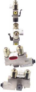

it is a small hand size part it is feed brake fluid by the master cylinder fluid goes in but doesnt flow through it if i unplug it my rear anti brake light comes on and stays on along with the emergencie brake light
its on the driver side behind the wheel underneath the drivers feet
some people told me that it was called ABS hydraulic cylinder is that true and if its not whatis it called

The rear anti lock brake system valve is taped to the wiring harness near the parking brake lever...called RABS valve! (Rear antilock Brake valve)

i figured it out but thanks
it was ABS hydraulic unit

well i pulled the part and brought it in to advance auto and they match the part excactly and it was under the drivers floor mat right behind the wheel bolted to the frame

thanks for the pic and i reconize that under my hood but if have already payed for the oart it is called a ABS Hydrualic unit i will be replacing it monday and i pulled off the fame under the driverss feet

thanks for the pic and i reconize that under my dash but if have already payed for the part it is called a ABS Hydrualic unit i will be replacing it monday and i pulled off the fame under the driverss feet[/quote:d26fea41d4] yeah thats a very nice pic but its not it,there is a brake hose in it and its a different shape, different place and its called a ABS Hydraulic unit ( just to make sure u are clear on this, when i said under the drivers feet i meent under the truck) it looks like this

That looks like te RWAB, anyhow good luck, and let me know how you do!

i always thought that was the rabs valve, every time i replaced one.

That's what my parts guy calls it too!

Well i pulled that part off the frame under the truck and when i showed it to them they matched it in their computer and it was called ABS hydrualic unit maybe there is another name for it idk but they had to ship it from Louisiana and get it tomorrow
