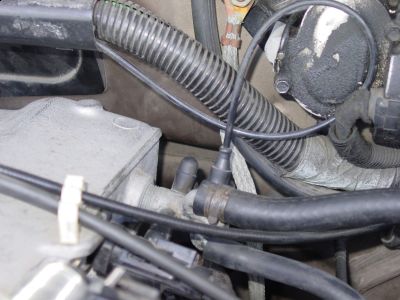

I am only getting 11 miles to the gallon! I have replaced O2 sensor, MAFTA air flow sensor, other sensors that I can't recall at this time. At sixty-five mph it will get a slight miss( flutter ). Diagnostic test shows all sensors working but that it is running very rich(930). If you pull the vacuum cap it drops to around(3-4). I have tried Fuel Injector cleaner but hasn't made a difference. I have to fill up every 3 to 5 days and mileage is consistently
11.45 to 11.75 ( Also replaced fuel filter and air filter )

Can you explain what you mean by Vacuum Cap (3 to 4)

https://images.2carpros.com/forum/automotive_pictures/397234_DSC00010_1.jpg
It is the cap to the left of vac. hose to brake booster. When they pulled that cap the reading of running rich(930) dropped to ( 3 or 4 )
Aug 18, 2009 at 9:15 AM
  • 110,244 POSTS
Sorry, I can't tell which is the booster vacuum hose. Are you refering to the rubber cap that is plugging a vacuum port? If so, that makes sense because you are allowing more fresh air to the engine. I reviewed our past posts. Has the EGR been checked to make sure it isn't plugged with carbon? I didn't see any mention of that.
