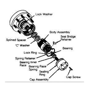

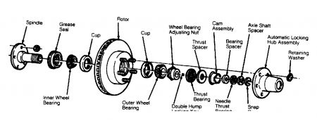

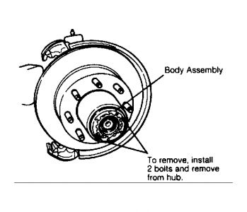

I had to replace the axle joint on the front passagner side. How do I put the hub back together?
