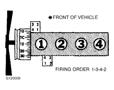

1990 Ford Ranger timing order
RALPHIE879
MEMBER
1990 FORD RANGER
Engine Performance problem
1990 Ford Ranger 4 cyl Two Wheel Drive Manual
timing order twin plug 4 cyl.

notice the two coils one one each side
